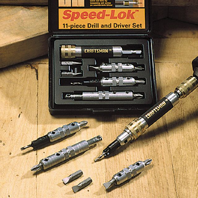

I agree w/ Jim on the DW screws. When working with pine and other softer woods, there is less chance of this problem of snapping the screw. It is a good idea to use the countersink/ driver sets (Stanley, Dewalt Makita etc) and set the pilot depth accordingly. Whenever using semi or hardwood, it is nec. to have a clearance hole besides the tapered countersink or you are guaranteed to snap almost every screw. By not using a clearance hole you are basically only threading the wood together, any space between them will remain once the head stops and continued turning breaks the screw.
Bob K.
I concur with Bob, as the reversable countersink and pilot drill bit / screwdriver was one of the best $25 I ever spent on my RR.
Click this to see the pic: http://s7.sears.com/is/image/Sears/00926175000
I used this tool (actually, one by DeWalt, but same differance) to build my entire 25’ x 50’ layout. I used nothing but drywall screws and I never twisted the head off a screw that I can recall in the thousands of screws I’ve installed. It’s a heckuva timesaver, as one can quickly drill and countersink the hole, then click the collar, flip the bit around exposing the magnetic Phillips head bit, lock it back down, then set and tighten down the screw.
