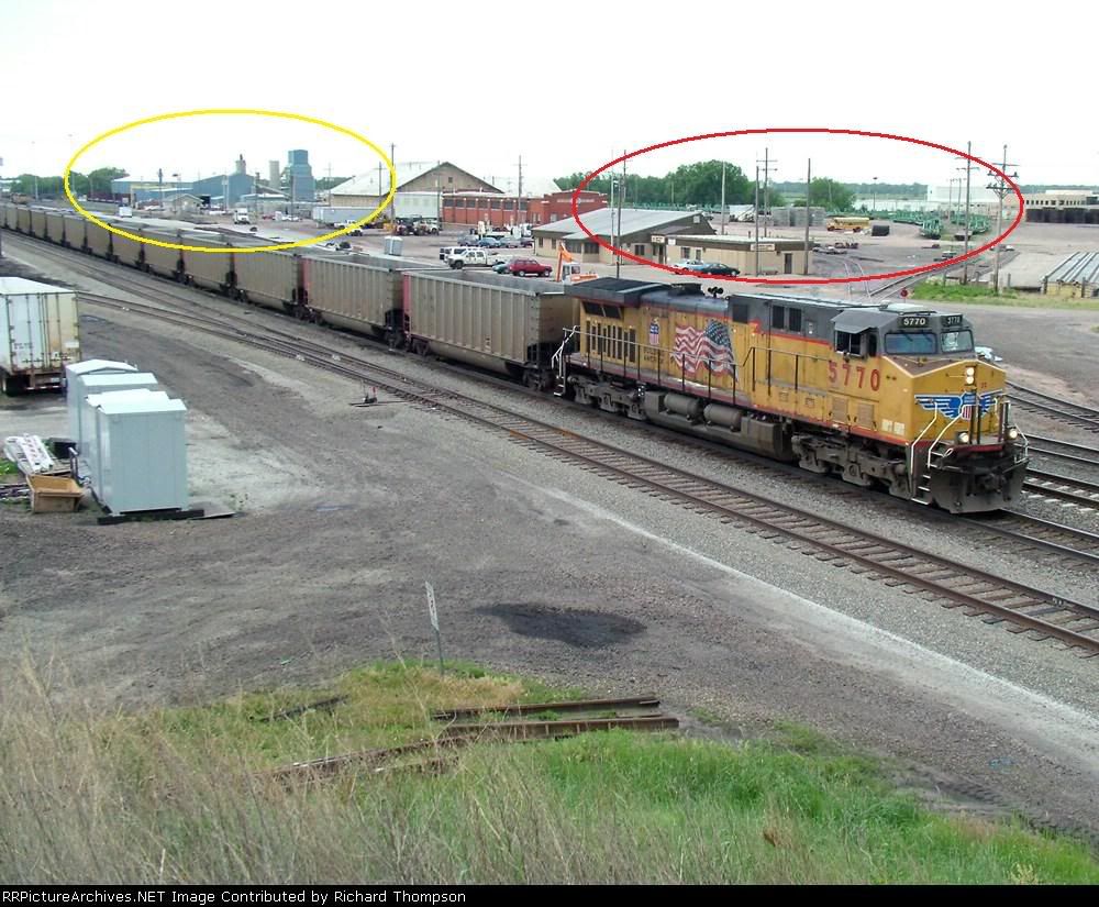

Thanks, I was aware that they operate with the track renewal train. When I build a layout I want to have it go atleast from Kearney to Grand Island Nebraska along UPs main corridor. I am planning on having LB Fosters / CXT tie plant which would require a few of these cars for emptys in / loads out.
In the photo below you can see several of these cars circled in red outside of the plant circled in yellow
Looks like scratchbuilding is the only option. Ill probably just start off with an Athearn/MDC 60’ flat as a start and make the brackets and tracks from styrene.
