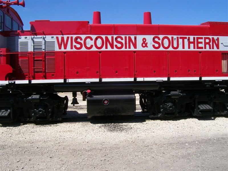

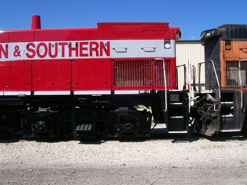

The MP15AC is a bit longer. Part of the extra length went to the radiator area. The MP15AC looks like a baby tunnel motor.
The MP15DC has the old-style belt driven fan in front, similar to pretty much all EMD switchers built before it.
SW1500 shown, but MP15DC looks very similar, just slightly longer with Blomberg trucks.
The bolster centerlines might be a bit longer, but the ones I have run have only a 1100 gallon tank, so there is plenty of room around it.
