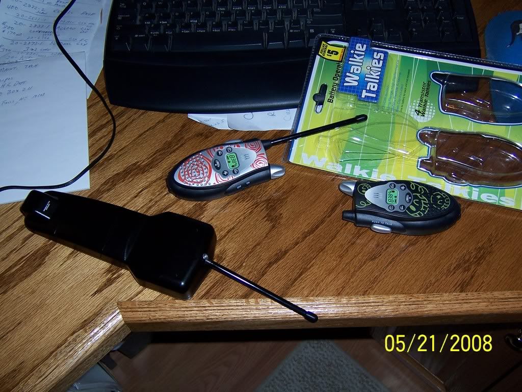

I also performed some upgrades on the equipment to solve communication errors. Here’s the latest antennas I 'm using. They’re from a Dollar General store set of $5.00 walky talkies.
They’re cheap and it seems to work so far. Joe P= jwpcfv@msn.com
Thanks for the “heads up”. All of us at Miss Edna’s have NOT upgraded as we are waiting for all the “bugs” to come out. Neat info on the antenna.
