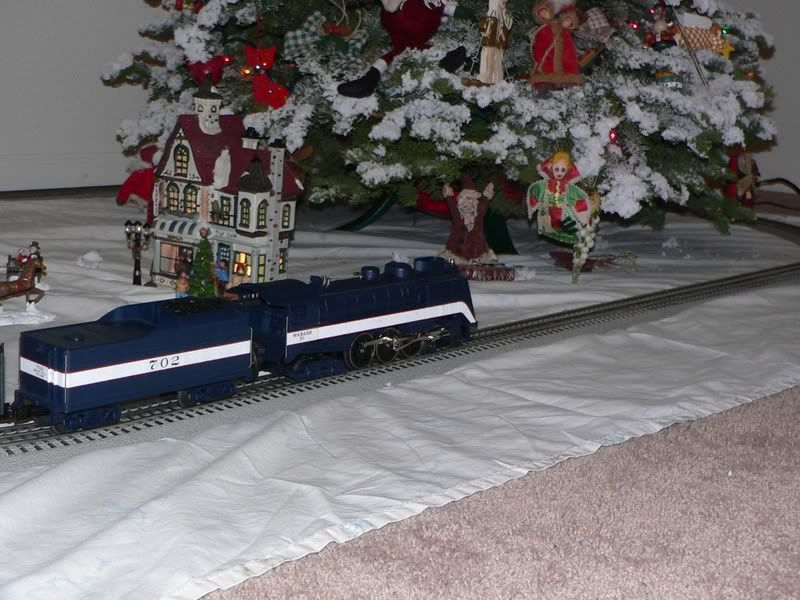

Got an interesting problem. After having run just fine for quite a while, my Railking Wabash Hudson decided to start acting cranky. No matter what I do, the thing just sits there when I turn the power on and makes a clanking (coupler crash?) sound 3 times and then goes silent. I wouldn’t ask here, but I bought the thing off Ebay a couple of years ago and it came without box and instructions. I thought perhaps I might get a quicker response here than emailing MTH with the symptoms.
My older grandson (2 years old) is with us now and the rest of the grandkids will be showing up soon. If possible, I’d like to get the Hudson back up and running. Thomas looks kinda ridiculous pulling the “Wabash Cannonball”. OTOH, the little guy pulls a lot better than I thought he would.

I hate to be the bearer of bad news, but if you are getting the 3 clanks of doom, it is NOT a good sign. I had an MTH NW-2 diesel switcher doing the same thing even the LHS tried to get it to unlock from neutral, and it wouldn’t respond. It went back to MTH, and I didn’t see it again for about 7-9 months. With ANY MTH locomotive, with ANY sound system, DO NOT EVER let the battery get weak, it CAN/WILL give you all kinds of grief. my understanding is that a low battery will scramble the control chip’s programming. there is a reprogramming kit, that I believe is about $25.00? to fix this problem, but I have not used or bought it. There is a sequence to unlock a locomotive that is locked in neutral, but unfortunately, I have not been able to find it in any of my manuals yet, HOPEFULLY someone else out here knows it, and can tell you how to do it, but if it was caused by a low battery, that may not work, but is worth a try.

Thanks, Doug. I wasn’t even aware the battery was weak, as the thing was operating just fine not 20 minutes before we got the “3 clanks of doom”. I’m going to pull the tender shell,see what kind of battery is in there and replace it. If that doesn’t work, then I’ll contact MTH to see about getting the thing unlocked.

So much for that idea. Now that the battery’s out, it’s obvious I need to get in touch with MTH anyway.

I finally found in a manual for my RailKing 0-6-0 which is PS-2 equipped the sequence for locking/unlocking the E-Unit Here directly from the owners manual:
LOCK INTO A DIRECTIONAL STATE:
You can lock your engine into a directional state(forward, neutral or reverse) to prevent it from changing directions. to do this, put the engine into the direction you want or in neutral, run it at a very low speed (<10 scale mph) and quickly but firmly press your remote’s Whistle button once followed immediately by three presses of the bell button. Two whistle blasts will indicate that the engine has made the change. The engine will not change direction(including going into neutral) until You repeat the 1 whistle 3 bells code to return the engine to its normal state, even if the engine has been kept without power for extended periods of time.
RESET TO FACTORY DEFAULTS
To override the settings that you currently have assigned to the engine and reset it to its factory defaults, while in neutral press the whistle button once, followed immediately by five quick pushes of the Bell button. Two whistle blasts will indicate that the engine has made the change.
It seems a bit complicated, again turn of the century technology (A simple slide switch) would accomplish the same E-Unit function Much more easily, economically and RELIABILY.
Andre, I HOPE that either one of these methods will help return your locomotive back to service, I am afraid it wont, but either one are worth a try. I would try the unlocking method first, and if No Luck there, then I would try the restore factory defaults procedure next, I am rather convinced that it is likely a scrambled control chip (Sorry Friend) but You have nothing to lose by trying and may get the “CANNONBALL” running again, but that Hogger is going to have that throttle WIDE OPEN trying to get that train back on schedule.
