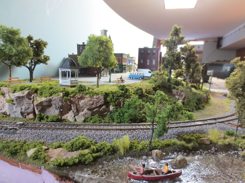

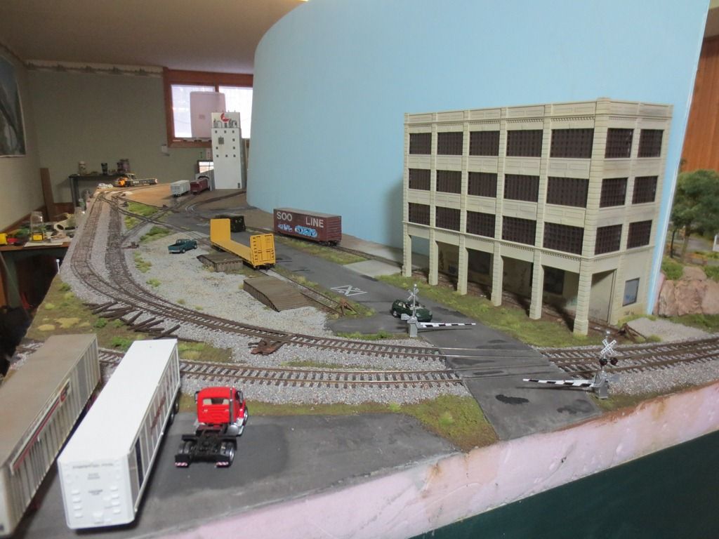

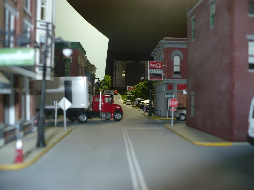

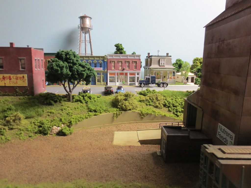

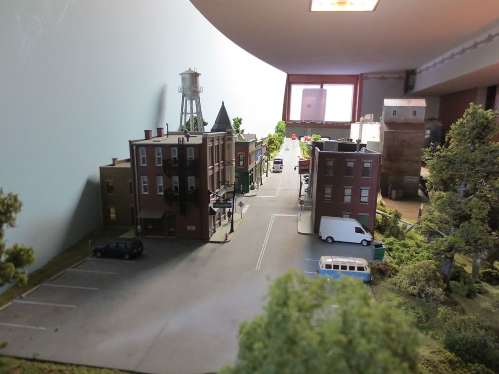

Thank you! I guess I was copying and pasting the wrong URL for each photo. More photos below:

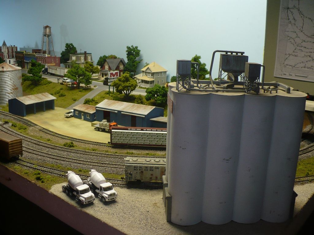

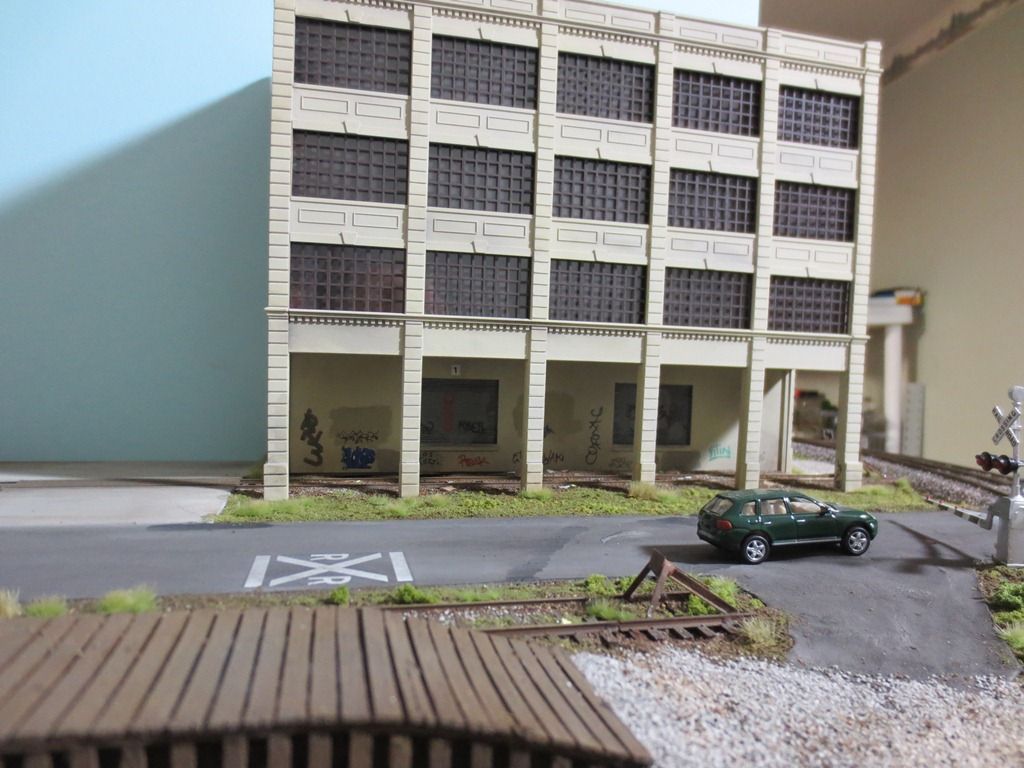

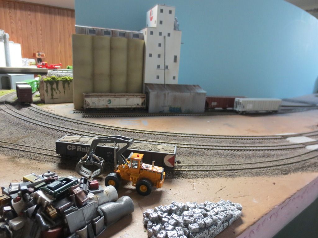

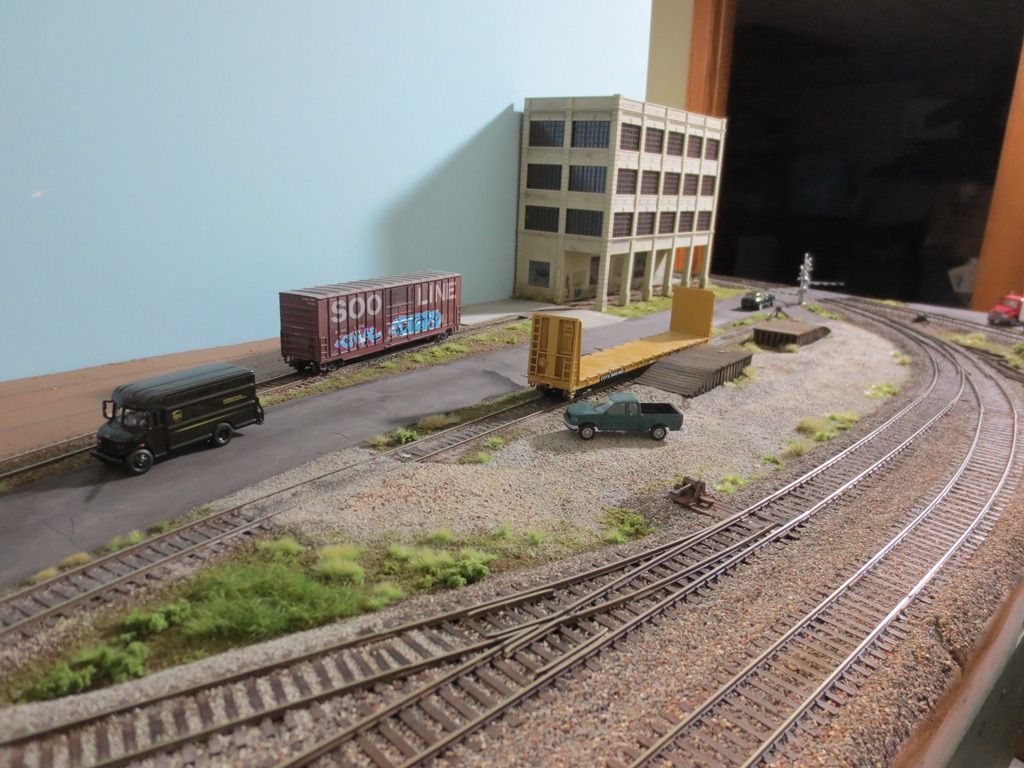

Now for the other side of the layout…

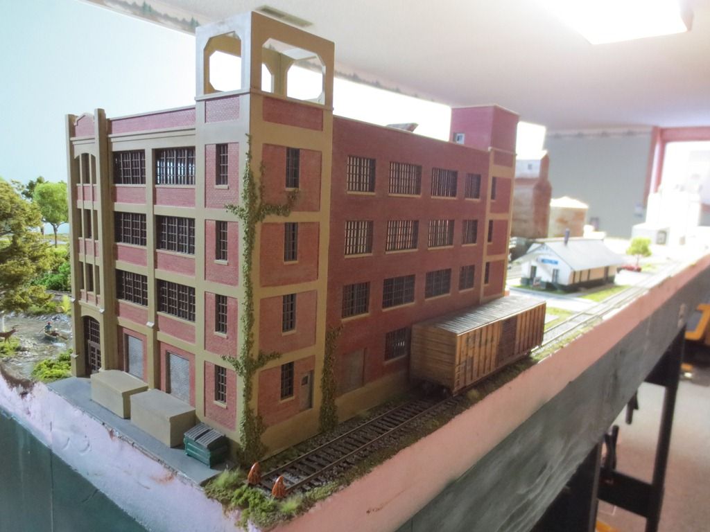

Lots more work to do here yet. I am planning on building my first scratchbuilt structure following the Lance Midheim formula of adding photos of a real building onto styrene.
Nice layout!
Looking great Greg!
I’m glad you got the photo posting down so you can share with us. Keep those photos coming of your project.

Thanks for the compliments. I will definitely post more pictures. I am adding on to the big grain elevator on the industrial side next. The area in front of it will be a storage area for containers. I love how containers look on layouts. Instant urban feel to them. Oh, and I bought a cell tower kit to go in that area as well.

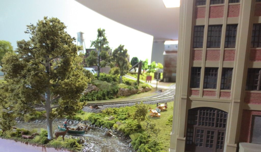

Your photos are excellent. I am especially intrigued by your very realistic trees. I just finished making 300 trees, using Super Trees and sage trunks. Do you use “Scenic Express Super Trees”,or what? Get that photo backdrop pasted on the backdrop before it gets too late to reach it. Bob Hahn
Well some of the trees are realistic and some not so much. They probably just look better in photos. I used a combination of Woodland Scenics trees for the most part. Mostly the already built trees, which do not look as good, but are actually cheaper, and then the Fine Leaf Foliage kits where you make the trees, and they look much better. I also have a couple of pre-built trees here and there from Bachmann I believe. Those are OK, but the trunks don’t look very realistic. I really want to upgrade a lot of the trees when I have the money to do it. The nice thing about the trees is that they will easily come out, and then new ones easily go right back in the same spot. Are you not satisfied with the Super Trees? I thought those were supposed to be pretty good.
The backdrop pulls straight out, so I can add the image any time. It’s just a matter of deciding on what I want the actual backdrop to be. Right now its styrene, and I have had several suggestions made for alternates, but the slot I cut for the backdrop (and it can not get any bigger) is not large enough for some of the suggestions to work. Thanks for looking!
