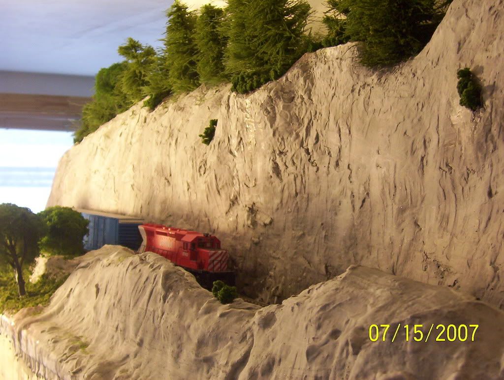

This part has a 2% incline

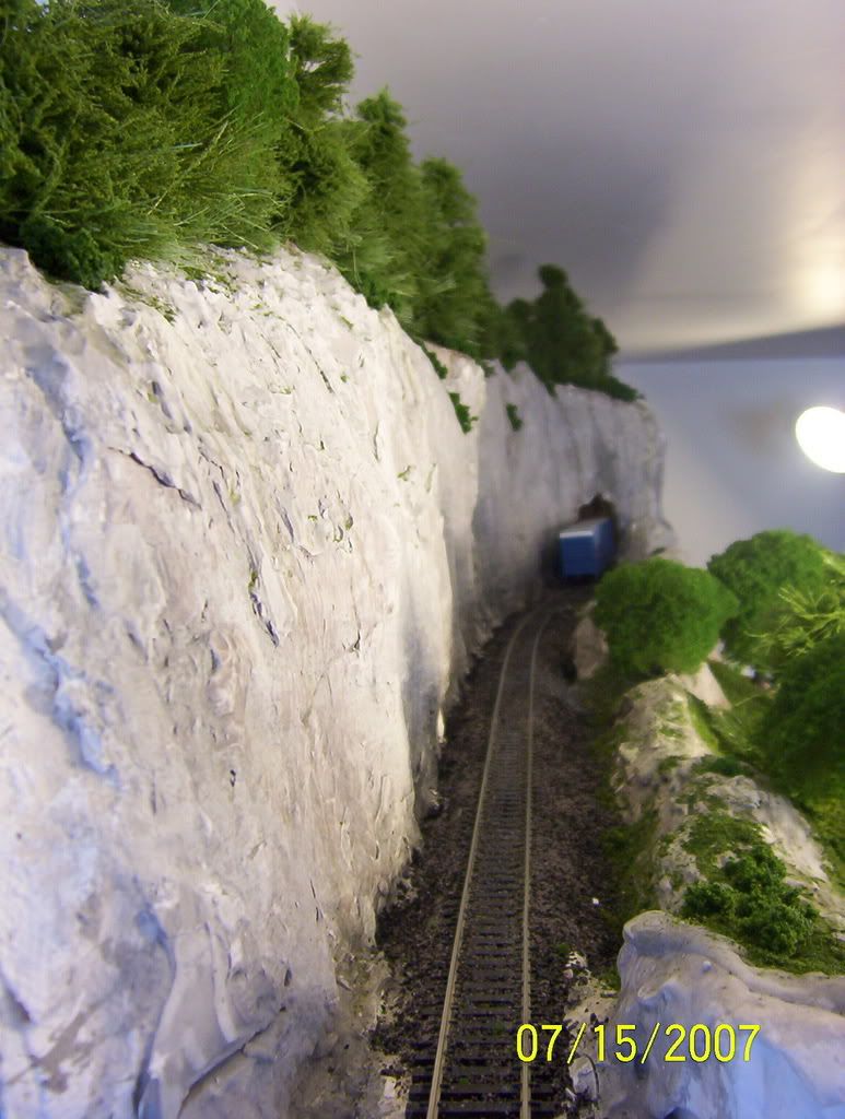

Another angle in a different more natural day light

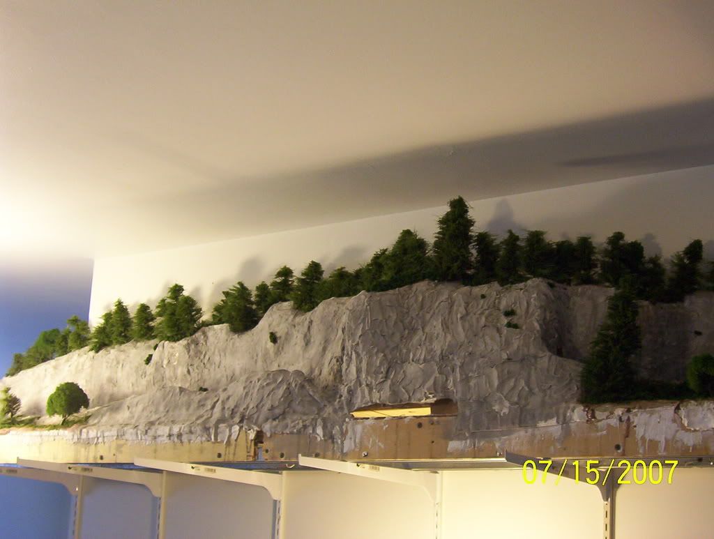

Here is a picture with regards to the location of the module
It was a wonderful learning experience getting the module this far, as well as trying to post pictures on this forum. It also taught the beauty of modules as can be seen here due to the fact that originally this was the first piece for a layout in another house in which I moved from a couple of months ago.

As for your module, it looks great! Especially the first pic. The pine trees also look good, how did you make them?

Looks nice, you did a good job. Why so high?
Thats a nice module. I like how the narrow the scene is for the trains to go through. Is that closet shelving you used? I am using that to build my layout.

And it is nice to see another successful wall stanchion and bracket benchwork system at work!

CSX Fan: Thank you for helping to post the pictures. As for the trees, they were made using the bottle brush method. The wire is the typical floral arrangement wire and the branches are made from string, in this case baler twine. It is the natural fibre baler twine, it was put into boiling water and then dried with one gallon paint cans as a weight to straighten out the strands. It is easier to work with this then the hemp type rope.

Virgina CSX: The reason for the height is due to a lack of space. Also being 6’1" elevated the layout to this height. The structure is made from 15/8*15/8 steel studs to save on weight but it has very sharp edges. These edges would certainly leave nasty marks if one were to bump their head on it. Only the ends have wood for ease of adding other modules to the end. Of course the roadbed is also on plywood.
P42 108: The shelving system is of the cantilever style which was purchased at the home depot. This way there is the ability to move the module up or down a few inches.
