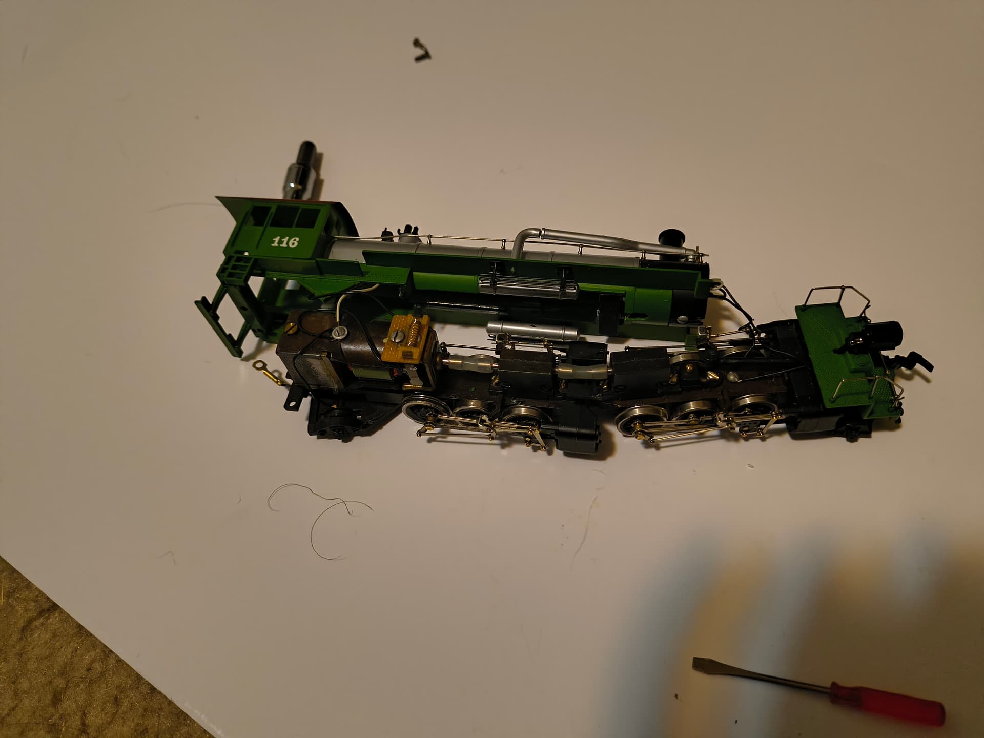

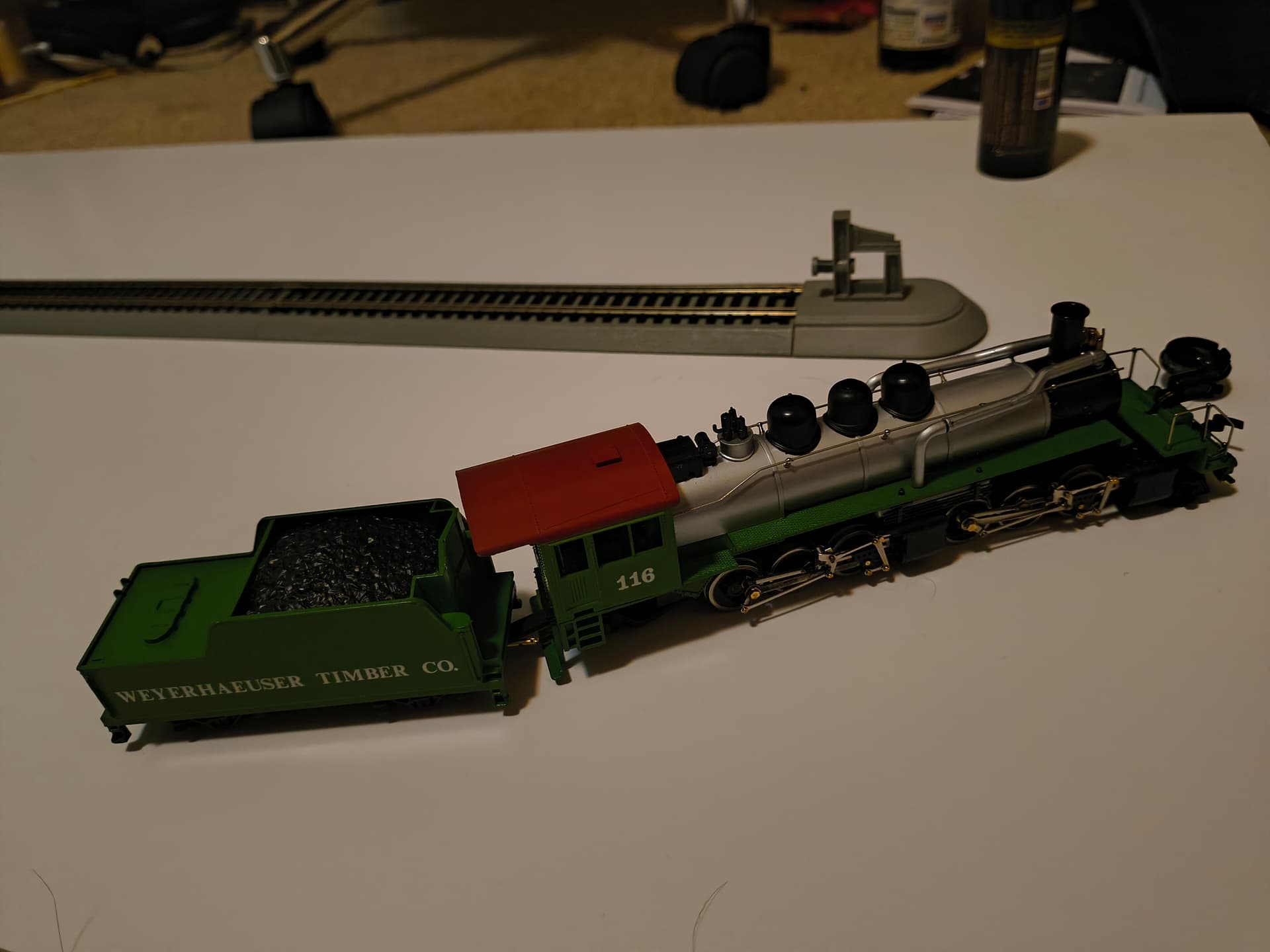

I’ve just purchased my first model train, a factory sealed Mantua 2-6-6-2 articulated.
Unfortunately it doesn’t run. The engine turns on, moves forward a half inch, and then seizes.
I was able to find an assembly manual for this kit but it wasn’t very clear on troubleshooting.
If anyone has worked on one of these before and has some advice I would appreciate it. I have previous modeling and wiring skills working with Gundam kits but this is my first time working with model trains.
I managed to get the shell off without breaking anything.

So believe it or not, I took apart the drivetrain and everything was perfectly clean. No oxidiation and all the moving parts were fine.
What happened was there was a defect in assembly on the front cylinder timing rods. A couple of them were slightly bent so I filed down the rivets and it runs fine as long as I don’t put it in reverse.
I will get a replacement set of rods that aren’t bent eventually, but it does run now.
I disassembled the drivetrain and worm gears and everything was still clean like a new car :rofl:
It turns out they made a mistake with the front cylinder driving wheels during assembly and bent the hell out of the timing rods, so I will need to replace them eventually.
