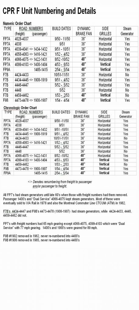

But I have to point out to you that that CPR 1432 was actually an FP7 with a 36" dynamic brake and horizontal side grilles. The FP9’s were only numbered 1405-1415.
Here is some handy info on all CPR FP7 and FP9 numbers and details
(click to enlarge)
