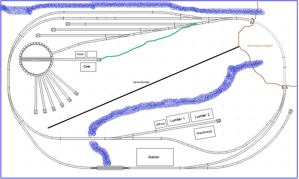

I’m doing a layout very loosely inspired by the locations where my fiance and I grew up, and running trains from the B&O and the PRR. The time period will be roughly 1920 or so.
My original plan was using Bachmann EZ track, but I eventually saw the error of my ways and am switching to code 83 flex track. Many of you folks generously spent your time helping me revise my layout to a plan that I really enjoy, shown below.
The senic divider will be a low hill, hopefully just tall enough to break up the scene into two areas.

I noticed you only have one approach track to the RH, I think you should have at least two and you track to the coaling/watering area could keep going and curve over and meet up with your other approach track. If you use a switch like this you will not lose a siding when you try to plug it in.
@BATMAN youre mentioning that at the start of the north siding? I assume it would have to be a reversing section then.
Your turntable has an auto reverser built in to it. Others can confirm, but you should be fine.
I am thinking this.
Got it, mcgillduddy (did I get that right? :joy:). Do you know a brand that makes a three-way turnout like that? Or would that be a custom job?
Walthers Shinohara used to make them. You can probably still find them on eBay. Peco still makes 3-way turnouts.
It’s a Walther’s product I picked up new in box at a train show for $20.00
If you strike out with that Walthers turnout, as noted, Peco makes a three-way turnout. When I built two staging yard extensions to my layout, Peco only offered this turnout in Code 100 rail. Like you, my layout is built with Code 83 track. You can do the rail joiner squash and solder job to make them work. It’s not difficult. Just be sure to get that inside running edge of the railheads lined up before you hit it with the soldering iron.

You could do something like this and then you would only need to buy a regular turnout.
