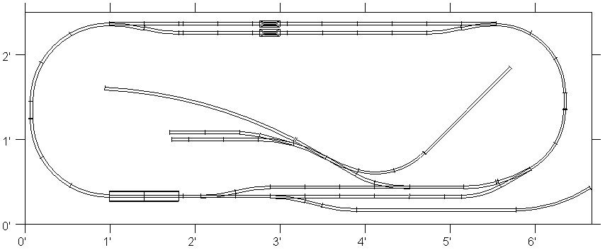

Hey guys, just getting back into this hobby after a 25 year or so break while flyin round the world for Uncle Sam. I am going with N for now while I am in a small apartment, and just picked up a hollow core door today. I am loosely following the trackplan of the Carolina Central from the book N Scale Model Railroading. It also appears in Model trains step by step.
The the plan calls for a 28 by 80 door. Well I have a 32 by 80 door, so I plan on modifying it a bit by using a bit broader curves etc. I am going to attempt to post it here in a sec. I used xtracad with the sectional track components, but I really want to use atlas code 55 flex track and turnouts instead. My question is, would the # 5 turnouts be ok to use instead of the #4s called for in the plan. I can’t see any problems myself but I want to make sure I am not overlooking something before I mail order all the track components.
I am brand new to this software and haven’t figured out the ways of using flextrack on curves etc. It seems kind of finicky, but that is probably user error not the software’s fault! With the extra width I have on this door, I shouldn’t have a problem, but just wanted some opinions or tips. I am also trying to find a place in the east bay area of N cal that sells the blue or pink foam. No luck at Home deopt or Lowes. I’ve read they have it down in San Jose, but that is a bit of a drive for me.

Here is a the plan so far:
Yes you can use #5 or #6 the larger the better. The blue foam board should be at Home depot or Lowes both carry it here in Kansas.

Yours is very similar to my N-Scale layout, vintage 1981. Except I had two levels. The town and staging on the lower and the mine on the top.
If you are going to use the back to tracks as staging, I would add a third track.
Minimum radius on mainline 11". Radius on mine spur 9 3/4".
This is not quite to scale since the track loop extended right to the ends of the 8’.
That is a very flexible trackplan. MR featured a version of it called the Jefferson and W Memphis and it has always been one of my favorites.
Let me tell you how you can operate it in a very prototypical manner. If you keep a eastbound and westbound trains in the tracks at the top, you can run them to the town in sequence to do work or together to do a meet or alternate between the two. One other option is to “narrow” the plan back again and use the space in the foreground to add a 2nd (or 3rd) yard track that doesn’t go all the way to the edge of the table. You might even want to move the switch to the off layout connection down 5-6" and put a left hand switch to the left of it with a short spur track for an engine pocket. Then you could base a switcher a your town and have the two trains in the back come around, set out cars, pick up cars and go back to the “staging” (the tracks in the back) Then the switcher could switch up the set outs, spot the industries and deliver the interchange, the track off to the right could be an interchange track to bring new cars on and off the layout.
