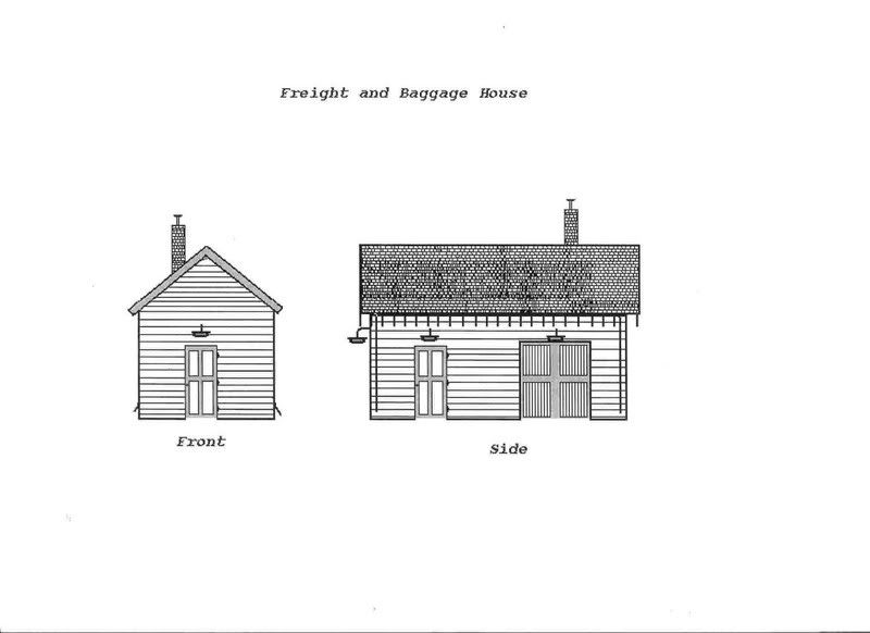

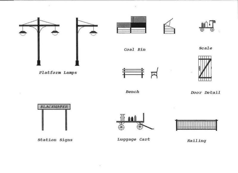

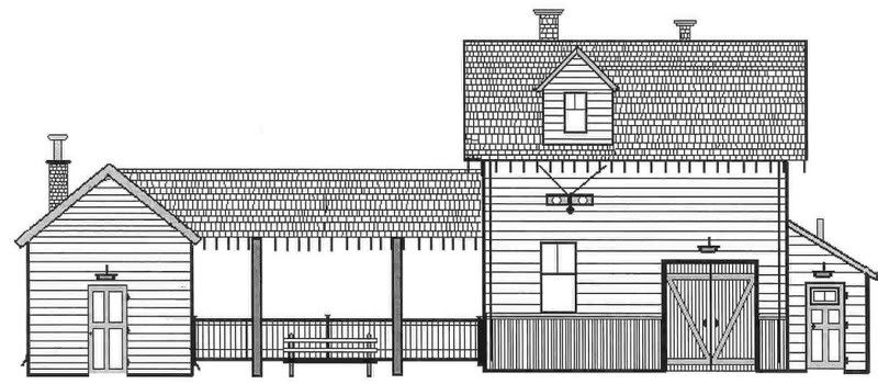

To help me visualize the finished model, I started the project by creating these drawings on my PC:

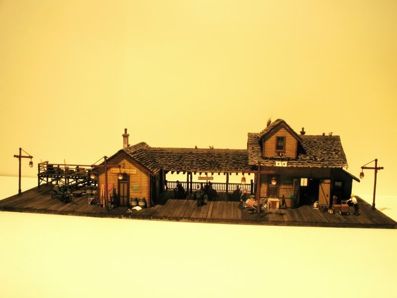

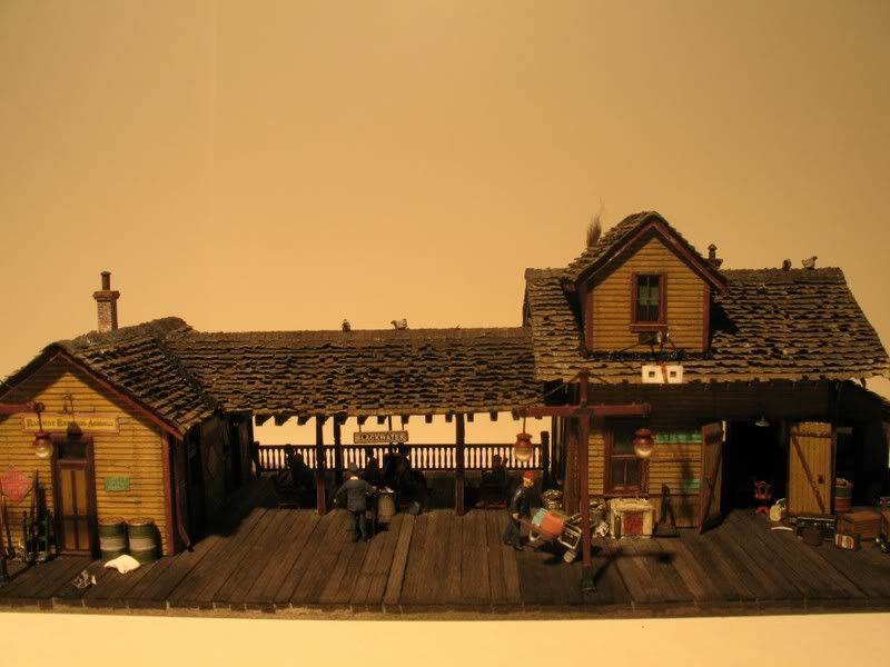

Here is the finished model:

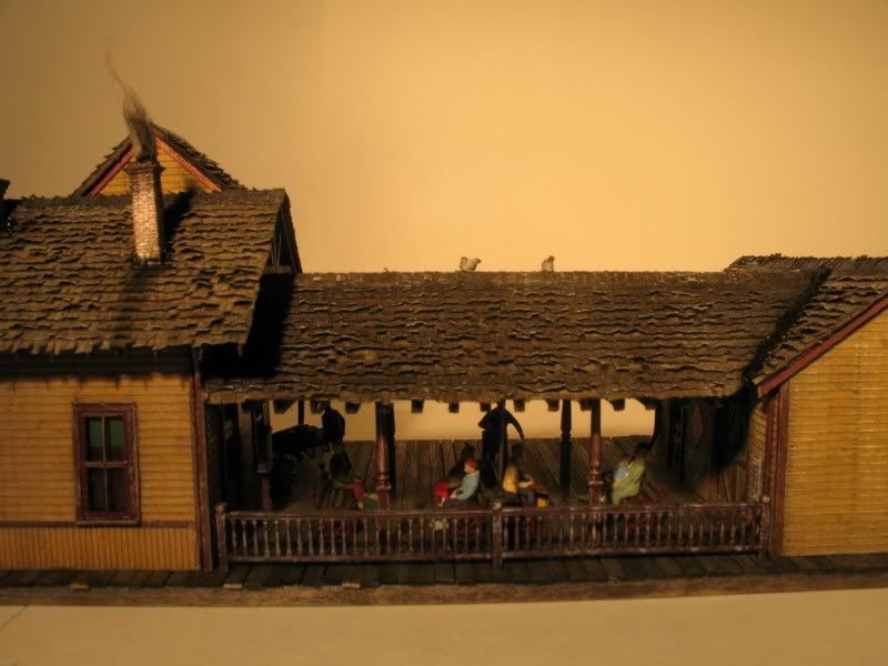

Close-up shot showing the passenger waiting area:

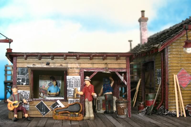

Close-up of station and baggage office:

I’m just curious. What program software did you use to create the drawings? Also, your station looks like it’s a pretty good size. Where do you plan on putting it?
Keep up the good work, Bob! You’re an inspiration to the rest of us…
Tom. The drawings were done using “paint”. Once you get the hang of it, it’s as easy as using an “Etch-A-Sketch”.
Bob.
Absolutely fabulous !
Paint. My young nephew taught himself the Paint program, available on every MS equiped PC. It is amazing the detail drawings he can do.
Meanwhile, the rest of us spend $ on supposedly easy to use CAD programs [%-)]

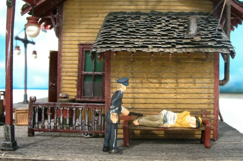

I finished the Depot today. Here are a few more pics to share.
I added a newstand at the north-end of the platform. I found these WS Bums at my LHS, and just had to include them.
Here’s another shot of the passenger waiting area:
A Question on construction - please.
In the picture above; do you use a red rail and add grey, or the other way around ?
As usual - terrific job.
Alan:
The weathering on the railing was done using the “dry-brush” method. In otherwords, the grey was dry brushed over the red base coat. BTW, I like to dry brush just about everything, as it brings out the hightlights in the details.
