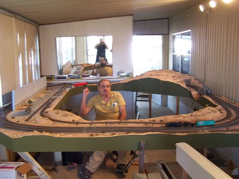

I recently purchased this modular layout from a friend who had lost interest in it. His loss my gain. It is a variation of the Jan., 2001 Wildcat Central built by another friend of mine here in central Florida. The scenery was applied to represent the southwest. I intend to expand the layout and add the necessary scenery to represent the southeast, say Georgia or South Carolina. Here is an image taken after the modules were assembled for temporary operation.

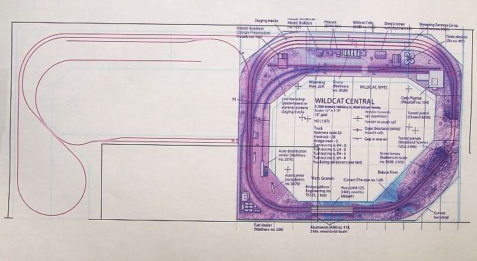

Well, looking at the photo I plan to come toward where the photagrapher was on the left side with a 2’ wide bench about 16 more feet and then a dogbone curve and come back down the same side and tie back into the existing outer loop. I drew it on Autocad and have photographed the drawing.
That’ll add some length to your main line … have fun!

I’m curious, just looking at the one photo here on this forum, I don’t see how it is being supported.
I’m also curious as to your thought on the height of the layout as it stands now. I know more conventional thought says about 48 to 56 inches works well, but I notice lately, my legs get tired easier when I stand at my layout for a long period. I’m actually starting to wonder if having a layout much lower, like rolling office chair height like your pike is now, isn’t actually the way to go. Probably tougher to have a duckunder however. Nothing’s perfect I guess.
Do you have any thoughts or plans as far as the height of the layout and the method of support?

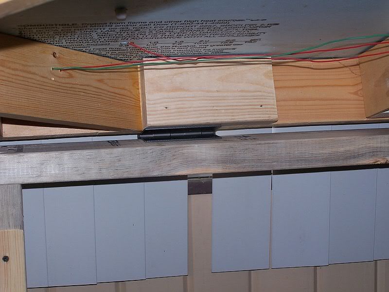

I am disabled and although I can stand I spend a lot of my time seated so the rail height is set at 38-1/2". The layout is temporarily supported on legs but it is hinged on the left side and we plan to install an overhead beam and use block and tackle to raise the right side to a sufficient height so I can get to my carport without ducking under as I am having to do now. the new portion will remain fixed in place, We expect some joining problems and will probably have to move all rolling stock to the flat portion before making the lift. I plan to install shelving and drawers under the benchwork on the left side to store extra rolling sock and model railroad supplies. The final plan is still flexible and may have to be modified as reality dictates.

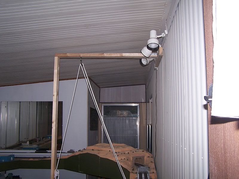

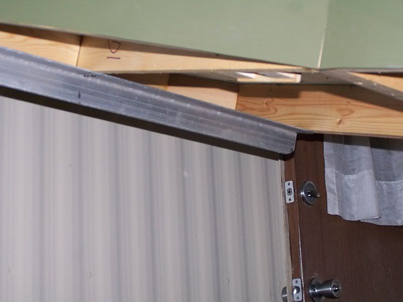

Some progress has been made regarding access to my carport. The basic hardware for my hoist has been fabricated and installed. I am awaiting delivery of a block that is needed to provide the necessary mechanical advantage. Here are some shots of the initial phase of the installation.
