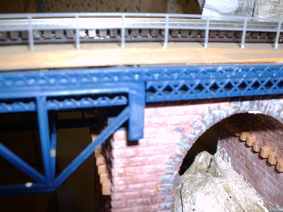

My take on Bierstchalter bridge kit
Twhite inspired me and this is how I did mine.
The final take

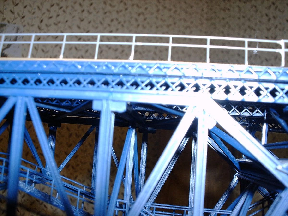

I added Central Valley box girders between the deck and arch to give it detail
I cut off the walk way and added my own wood walk. This gave view into the structure
I added Central Vally little girders where the walk was cut off. It added detail.
Last I added some vertical supports to make it look like it was standing there.
It was a fun kit and if I can get Kimm’s Kanyon done it will be what people see when they walk in.
Thanks to all of you for the encouragement.

Art–thank you for the compliment. What you did is VERY cool–in fact I’m afraid you’ve inspired me to do some retro-fitting. I like that wooden walkway, and the CV girders give it a much ‘heftier’ feel. Really nice work–isn’t that a honey of a bridge, though? Maybe we’ll start a trend, LOL!

Steve,
The bridge cost about $60 and the girders were about $15. It took better than a month to build and was fairly easy, though the directions were not very good, but I figured them out so anyone can. It did more for the layout than 2 $40 or 4 $20 kits. Adding the girders was a matter of making it up as I went along. If I had it to do over, I would cut the walkways off before I started to build.

I got the Central Valley Girders from my LHS but they were everywhere on the web including Central Valley Hobbies. The bridge is for double track in HO and would modify easily for S, if you cut the walks off. Might be a bit small for O. Adding the girders would be especially fun in S.

You may want to build the bridge first. I thought I had left a place for it, but it was too grand for the angles I had, and I had to change a significant section of the sub-bed to have it fit. Fortunatly I had all the risers screwed, not nailed and latex caulk holding everything down. It took an extra day but now its right.
