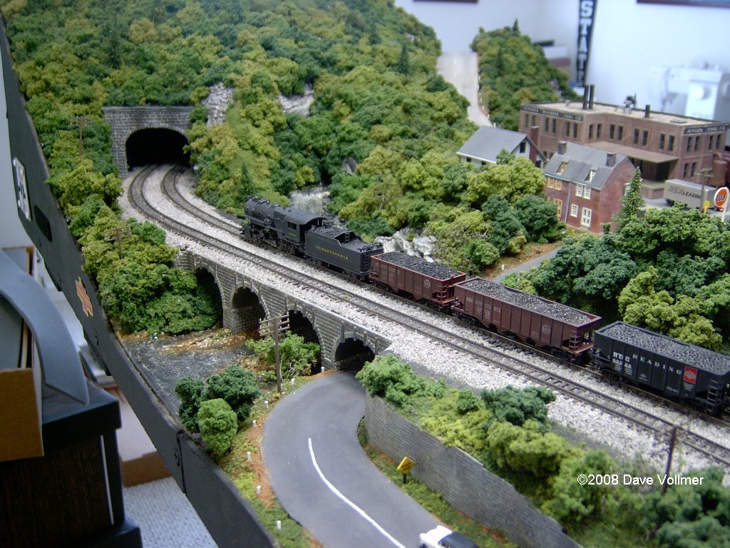

Hi Tommy,
Would real vegatation hang over the retaining walls that much? I don’t know what things look like in your neck of the woods. Just something to ponder.
I like the log over the creek idea (used it myself). The log itself is a bit large in diameter compared with the visable trees. Are there other large trees nearby but out of the shot? Also consider where that fallen tree came from. If it wasn’t placed there by man, then maybe add a stump near one end and a part of the top near the other. That one little detail will help turn a good scene into a better one.
You’re off to a nice start and these guys have given some excellent advice.
Karl
PS: Glacier gravel co. building in the background ???
Hi,
Looks like a great start for both the tunnel and river. A little smoke soot weathering above the tunnel portal, and on the track below will help with realism. Before you pour the liquid water, be sure that the base is level, and perhaps paint the river base blueish brown. Get one of the Scenery books from your LHS. Below, is a shot of one of the rivers that is cascading down a deep ravine. I use Magic Water, but any other brand works well. Add rocks, branches, fishermen,as well as white slashes to indicate rapid flowing water around objects, or over falls. I used a commercial river and forest background. Bob

On piece of minor wisdom I’d like to pass along. The building stone quarried in Pennsylvania and used by the Pennsy was typically brownish in color and very dark. Most photos I’ve seen and PRR stonework I’ve inspected in person are such that the mortar is much lighter than the stones. This is sort of the opposite of what most modelers do when they flow a dark wash into the mortar lines. Here’s what I mean:
