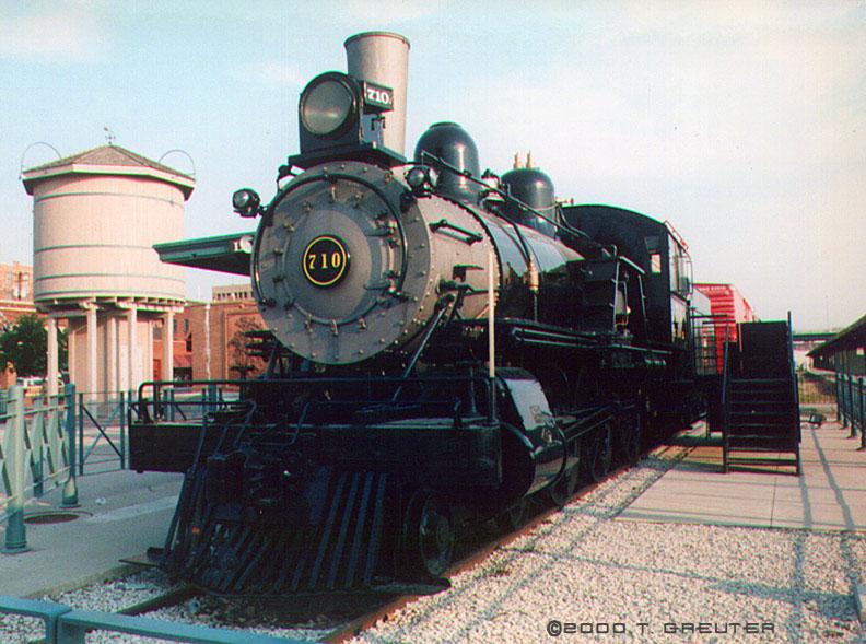

Searching other forums located a CB & Q engine 710 displayed at Omaha, NE but it is an all together different machine built in 1901 and rebuilt in 1928.

I would like to know how “Safety Valve” found that library image of a #710 N & W locomotive, by chance or a systematic index search? I agree with the other observations that it is not the mystery 710 because of the mechanical variations especially the head lamp and steam domes.

Lists a 710 (a 4-6-0) from the CB&Q, but the stack and domes are wrong.
Same one found at: http://www.trainweb.org/screamingeagle/gallery/cbq/cbq710.jpg
But those photos indicate another thing that might help identify the one in question… it has what is called a “Wagon Top Boiler”… (i.e.: the boiler has two diameters, the front being smaller than the back). The CB&Q engine refered to here is a straight boiler or at least has a smaller change in diameters. The mystery loco is much more pronounced in diameter difference.

Give me 2to1 odds and I’d bet the mystery loco and the Burlington 710 pictured on the steam locomotive info web site are one and the same. Note the similarities: headlight, sand dome, number plate, front end angle braces, cab roof curvature and that distinctive pilot. The CB&Q 710 as orignally built probably had square steam chests as shown in the mystery photo. She was undoubtedly rebuilt, maybe more than once, in her career at which time the stack, steam dome and cylinders were replaced to the configuration shown in the much later color photo.

I agree that rebuilds did occur and could certainly alter the looks of an engine. Including altering the number of wheels! But, I can’t see enough similarity to the CB&Q for it to be the one unless it was a massive rebuild… and that much of a rebuild would probably have changed the engine number.
