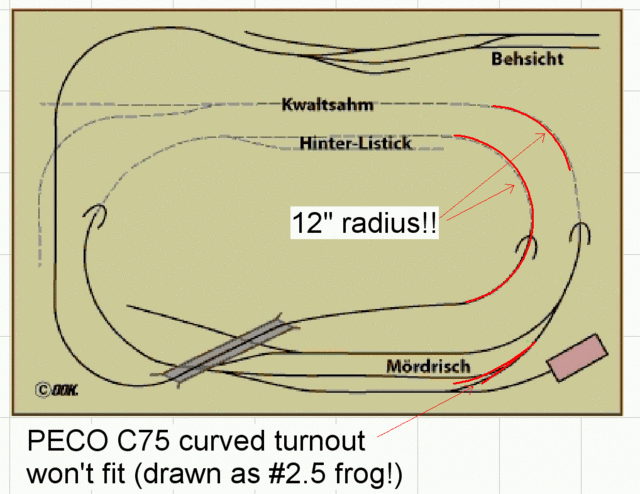

The plan by Wolfgang, he is building a splendid layout (he provided a link, so take the chance to see his wonderful work), is a tricky one. It is a Gore and Defeated #1 (by John Allen) look-a-like. His drawing is not to scale and John Allen applied a 13" or 14" radius. Wolfgang is doing the very same, which means that a lot of equipment can’t be run.

Sorry Wolfgang, but to that layout, I must say No No No.
At least not in HO for a beginner. This is the problem with hand-drawn layouts. When we take that drawing and make it a scale 4X8 and then try to draw in the actual radii, it’s all the way down to a 12 inch radius!
That’s very tight for HO and certainly not recommended for a newcomer as is the original poster.
Morevover, a number of the turnouts are drawn unrealistically sharp, including the one near Moerdrisch that scales out to about a #2.5 frog. Even a very compact curved turnout like the PECO HO Code 75 won’t fit as drawn.
That layout could work in N scale, of course, although I think there are better choices.
The plan reminds me of John Allen’s original Gorre & Daphetid layout which was smaller than four-by-eight. The plan should work in HO with some track realignments with 15-16" radius curves and custom/hand-laid turnouts with no. 4 frogs, probably necessitating the hidden track moved so it is under the upper town. Perfect geared-locomotive territory with the sharp curves and inevitable steep grades.
