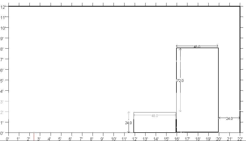

Have you also placed your L-shaped table into a corner, so you will have poor access to the rearmost part of the four foot deep table, and cannot split the table into two scenes by using a center view block down the spine of the table?
If you want a layout crammed into a corner, it may be smarter to have a narrow waist in the corner, and wider parts at the right and the left. E.g. in this style (ignore the track plan - that is something more urban from an old design):
Or is it oriented with the 4x8 sticking 8 feet into the room from the middle of one wall, with access to 6 feet (and a 4 feet long and 2 feet deep shelf) along one side of the main table, and 8 feet along the opposite side, allowing the use of a center viewblock down the spine of the table?
How about starting with a drawing or verbal description of the room the layout will be in, showing and/or describing how the layout will be located in the room, and what other uses of the room the layout will have to co-exist with?
Then it would be possible to start by seeing if it perhaps would be smarter to cut down that 4x8 feet to 30 inches x 8 feet, or relocating the layout in the room, or relocating the layout to another room, or considering some other footprint before continuing to look for a track plan?

The room is 12’ X22", the 8’ section is against the far wall as you walk into the room…it spans the 12" section, the 6’ L runs along the 22’ wall…I have allowed 2’ of space to walk around the layout, and have easy access to all sections of it. It looks very similar to your drawing if you took the 8’ section and ran it along the closet wall and had the L part on the left side. I also had a 8’ X12’ room built adjacent to the train room, that has 2 work benches, cabinets, tool storage, etc…Both rooms ared dedicated to the model train effort…the main room also has a Vermont Casting gas stove in a corner away from the layout.

I tried to visualize from your description how the layout table is located in the room, but got a little confused by the combination of the 8 foot end “spanning the 12 foot wall”, having 2 feet of access around the layout and having a six foot run along the 22 foot wall - somehow those numbers doesn’t quite add up for me.
Is this a correct interpretation of what you described?
Or did you mean something else?
