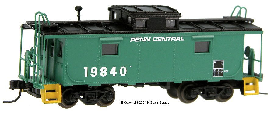

Is this the one you got?
Or was it this one?
These are the only two current Atlas offerings that I could find.

The top caboose is one Penn Central acquired from the New Haven when it was absorbed into Penn Central in 1969, one year after the 1968 PRR-NYC merger. The bottom is an AT&SF prototype.
