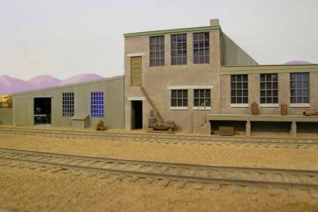

If you can splurge and go to a 20" layout depth, you’ve got room for this:
In the fourth picture, that’s the mainline running between the buildings to staging (on the opposite side of the aisle). While this industry is a great traffic generator, it demonstrates that you don’t need a lot of layout depth to model a good-sized industry. It could just as easily be a 19th century brick warehouse, or a modern steel or concrete plastics manufacturer or food processing plant.
My layout is railroad right-of-way 14 -18 inches wide on a shelf, so most of my industries are low relief structures or just industrial flats. The corners have room for a full size structure or two.

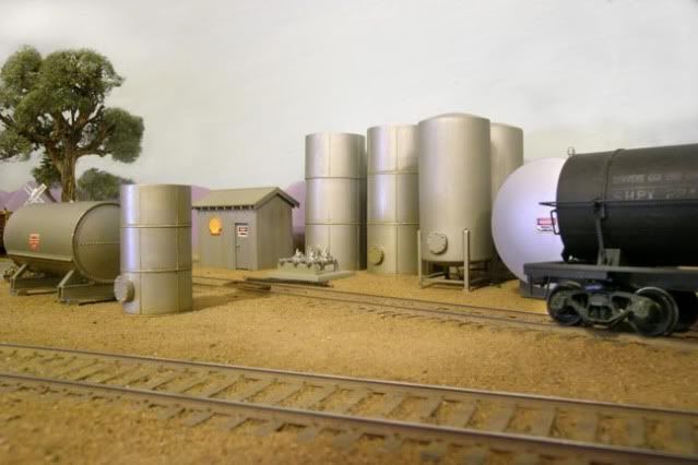

Low Relief: Modeled after the Strongheart Pet Food Co.
If you don’t have room for big tanks, use smaller ones.

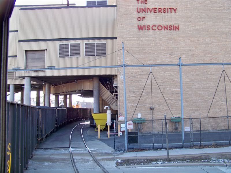

Some smaller power plants unload maybe a dozen cars a day when busy. There are two in MADison of that general size. Both use normal hoppers, not busy enough to need a rotary unloader.
MG+E has an enclosed building that they use to thaw the cars out in winter, and to unload. They use a car mover to move the cars around.
The UW just has a pit that they unload over. Full spot for them is 4 in the plant, 2 more above, and 6 down below. They use a front-end loader to bash the cars around. In winter, unloading slows down a bit when the coal is frozen into the cars.
Shot of the plant. The 2 cars closet to the engine will get spotted between the road and the main. The sixth car in is over the pit.
Looking back towards the main. Two cars fit here.
Tight turn getting in here.

It is a SD40-2 in the pictures. Not really sure how it stays on the rails. Lots of groaning and squealing through the turns. About all I can figure is that the rails in the concrete can’t move, otherwise the rails would spread and I’d be on the ground.
