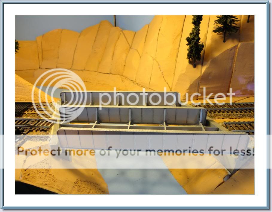

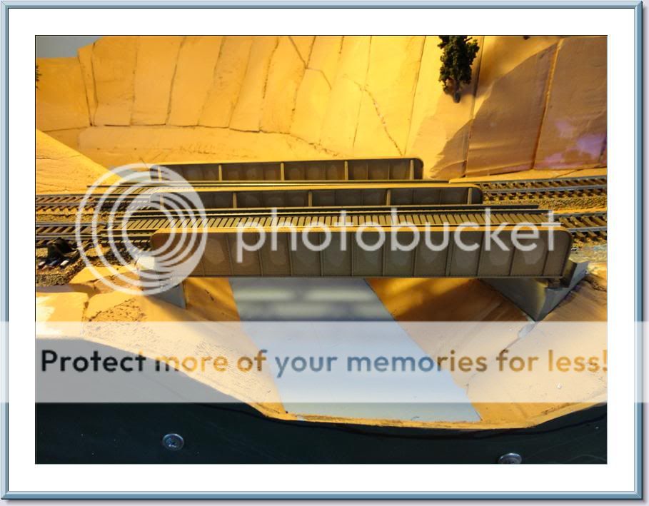

well my first go before I got the last couple a post ,thanks for the info bye the way. Any way kinda captured the look thats in my head ,but the results are missing something but its close ,well mess with some hand work later this was just a “got out a hand” air brush session ,I love playing with new toys[;)]
after
before
another view
thanks …oh ,the funny looking circles ,as my wife calls em ,are suppose to be faded panels with rust closing in at least thats the way I see it in my head …Jerry
That looks really good JERR. But the circles don’t blend. Maybe use the powders to try to blend them a little more with the rest of the weathered color, which by the way looks real good.
A little touch up, and you be good to go!
