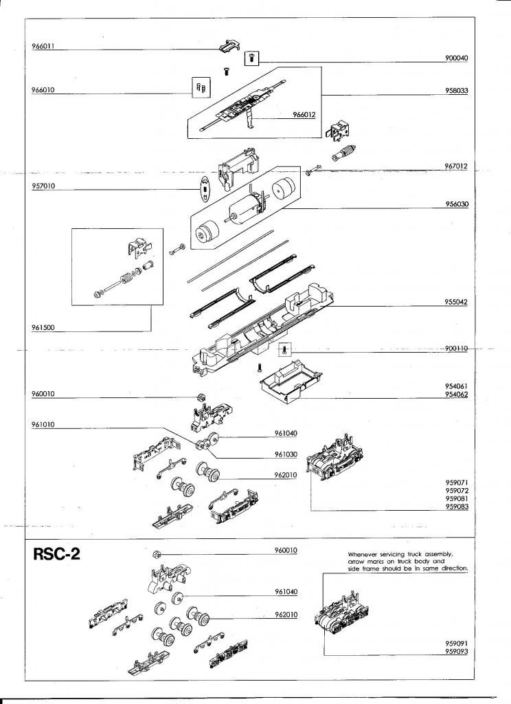

So, I presume I have a connection issue between the truck and the common brass ribbon running along the top of the frame. I could investigate further but need to remove the truck to do so. Does this come off like a Proto 2000 truck; i.e., is that a clip atop the worm gear that gets pryed and removed, then the truck drops out. Please advise in detail as I don’t want to break anything.
I’m surprised one truck works so well providing power and the other not at all. Any advice most welcome. I’ve attached a drawing:

Remove the tower clip and the truck will drop away.
