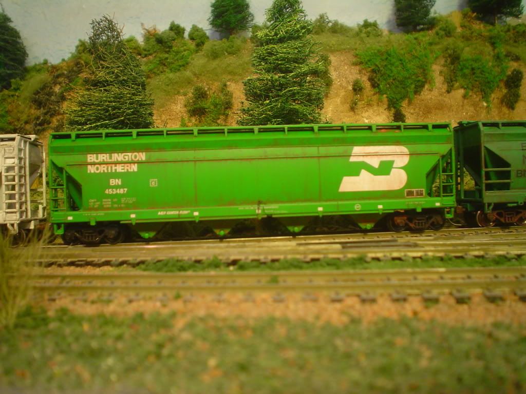

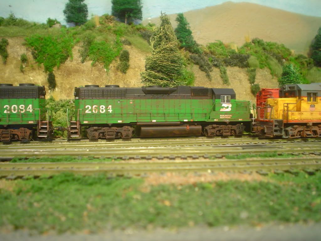

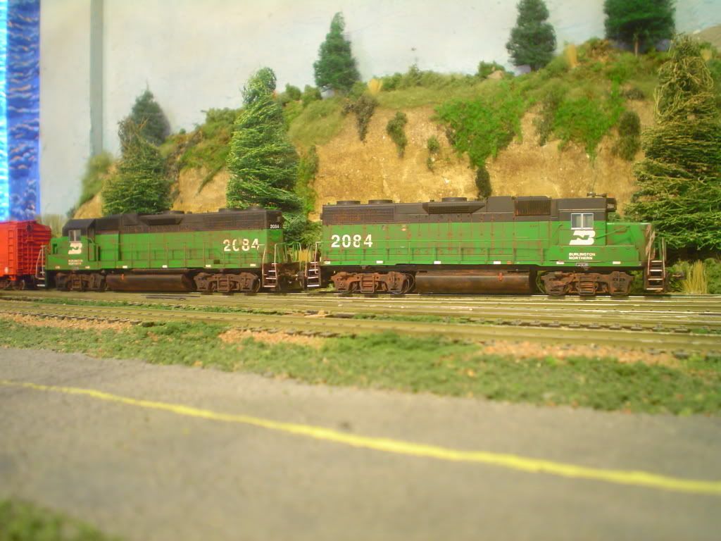

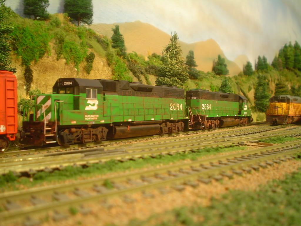

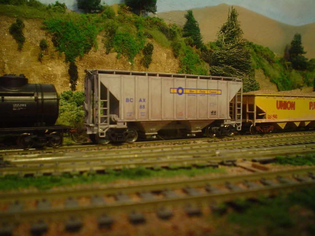

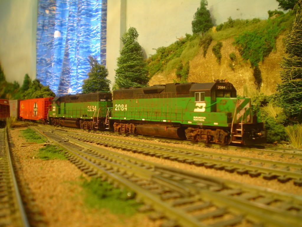

Good afternoon to you all, I have been doing some weathering on some of my locos and rolling stock today, and I don’t know if I know what I am doing. This a first for me and would like your comments and opinions.
These are the locos I have got done
Thanks in advance for your help, what do I need to be doing or what do I need to stop doing?
Mike

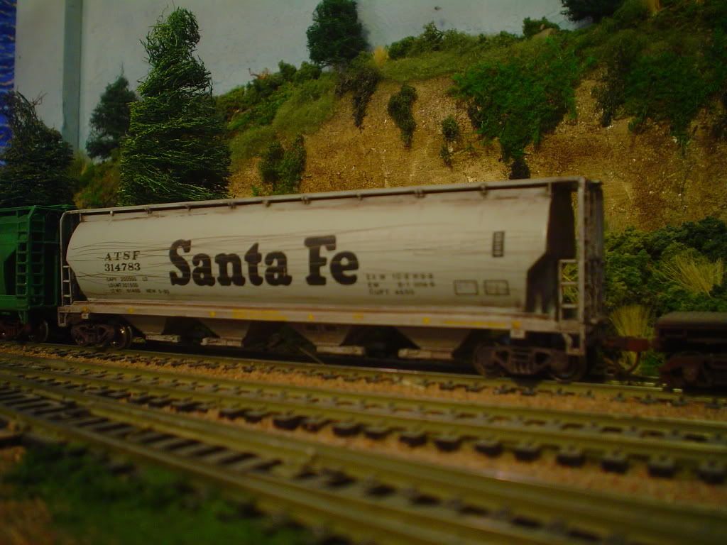

I think they look great. The only thing I would do different would be to streak down and not across. The Santa Fa hopper would look great with the streaks down and not across. You might want to try some different shades of weathering. How did you do what you did? Don’t get me wrong, I think it looks fine. If thats your first attemp then you are way ahead of the game.
Thanks 8500. The streaks on the hopper are supposed to represent deep scratches, as I used the point of a hobby knife. I used a mixture of India ink and alchol with a little chalk applied with a small paint brush after the ink mixture was about 1/2 dry. on some of the cars I wiped them off befor appling the dulcoat. Mike
Looks good Mike ive got about 40 cars to do what is your mailing address? LOL! Dave P. S. got a new genesis F3 w/sound today boy am I having fun runs and sounds great. keep up the good work .
They look great like they are. Any more will be overkill.
Nothing wrong with them for your first ones done. Just take a look at any thing outside and you will find all kinds of weathering going on around you! I love the A and I method along with chalks. Thats the most that I do with my weathering so far. Kevin
I think they look good, especially if these are you first attempt. A couple of the photos came out a little dark. On the ends of the covered hoppers, did you streak the slope sheets and car end with some muddy colors to similate mud and grime thrown up by the car wheels? I see this on the prototype and think it adds a very good effect. Tweet.

  1. rain washes all dirt and crud downwards… except where it runs along horizontal ribs… until it drops down again.
  2. dust blows up and around and clogs in places people don’t poke it out… like the angles you get in under the ends of covered hoppers and hoppers.
  3. rust occurs anywhere the paint doesn’t work… bad rust can run streaks down the car sides
  4. It has to be going fast to streak horizontally… like those buffalo heads you sometimes see on walls…
  5. if there is a gouge… it has to get through/bend any rib before it can hit the flat car side…
  6. feet and hands scuff, polish and/or break any surface protection and let rust in… mostly around steps, ladders and brake wheels.
  7. Brake hear is regularly greased to keep it free working and the grease holds dust and/or gets hot in the sun and dribbles
  8. Diesel smoke crud blackens the tops of locos… it doesn’t have to be intense… some at least wll build up over time. Sometimes it is easier to represent this just by dulling the top of a loco in appropriate patterns/areas rather than by trying to paint them. (In the acrylics “lamp black” is a good dull black - works to represent grease around drawgear and brake chains as well)
Hope these notes help [:)]

I think you’ve done a pretty good job, Mike, especially for a first attempt. In my opinion, though, that front handrail on the lead diesel in your last two shots is a bit “too weathered”[:D]. Dave has some good suggestions, as usual, and if I may add a few? Paint the sides of the wheels on your freight cars. Most cars with roller bearings have wheels that are very visibly rusted. They may also have other crud on them, too. On older cars, with friction bearings, usually the wheel faces are oily/greasy looking, again with other dirt and crud over that. A very simple way to weather the trucks is to paint the wheels an appropriate colour, then give the car a light spray of a suitable dust/dirt colour along its lowest portion. I usually do this, using an airbrush (although careful use of a spray can will also work) by placing the car on an old piece of track in the spray booth, then manually rolling it as I spray the truck area and lower carsides. This light spray will highlight the details on the truck sideframes, too, like the springs and bearing caps. If you do this step, it’s also easy to also add the spray pattern thrown up onto the car ends by the adjacent cars. Simply cut a mask (I used .040" sheet styrene) that’s the same width as the car ends, and at least as high as your highest car. I also added abbreviated sides to this piece, so the whole assembly slips over the end of the car. Cut an opening for the coupler to protrude through (leave it open right to the bottom of the mask) then cut two inverted "V"s, extending from the bottom edge of the sheet, up to about 6 scale feet. These should be on the same spacing as the wheels are on the axles. Place this over the car end, and using your favourite dirt/crud colour, give the car end a quick shot with the spray. Less is usually more here, and don’t hold the mask tight agai

Hi Mike. Those are the best you have ever done, though maybe not the best you will ever do. I critique with caution in that I don’t do this well, but when I compare them with Aggro’s, his are more “subtle”. I like the scratches, but they begin more abruptly than in real life. Now, how you accomplish this “sublety” is beyond me, but I watch your posts with interest and someday will get to that stage on my layout…
