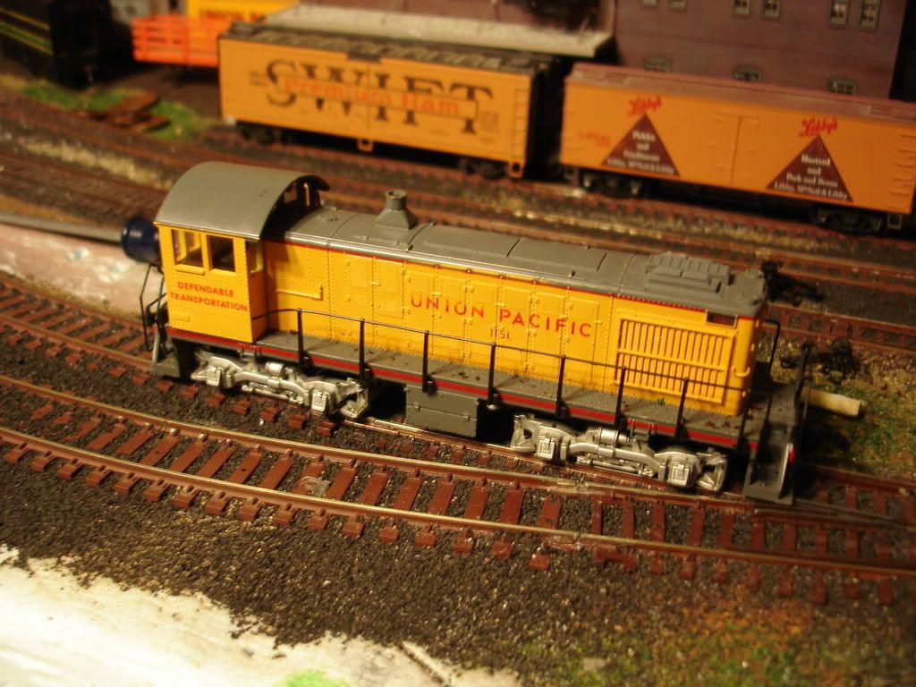

There’s a screw on the bottom which I have out but nothing feels like it comes loose and the hook couplers have a screw from the top. Don’t want to damage loco since it runs great.
Thanks,
Fred

Fred those are pins you are referring to. They should come out from the bottom.
http://hoseeker.net/assemblyexplosionAtlas/Assembly%20Explosion%20Atlas%20S2%20S4.jpg
http://hoseeker.net/assemblyexplosionAtlas/Assembly%20Explosions%20Atlas%20S2%20S4%20pg1.jpg
Here are files you can save on your H/D.
http://www.atlasrr.com/pdf/S4%20SWITCHER%201.pdf
http://www.atlasrr.com/pdf/S4%20SWITCHER.pdf
Jim
Thanks, Jim.
I will print a copy and go and replace a coupler or two.
