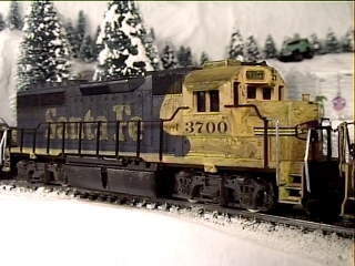

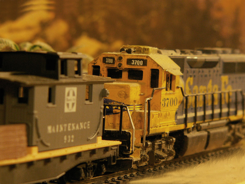

I think it’s an old school Atlas GP40 from the 1970s or 1980s. I have two of them. They run pretty nice. The are better than old Athearn blue box kits. They do lack some of the details of more modern productions. I added aftermarket details to them. One telltale sign is tall the sand filler on the nose. Another is the handrails and molded chain. The GP38s that Atlas made back then were the high nose versions.
!http://www.trainweb.org/lonewolfsantafe/sf3700.jpg
!http://www.trainweb.org/lonewolfsantafe/sf3700a.jpg
They made low nose ones also.

Atlas did indeed make a high-nose GP38 – but they made a low-nose version as well. I owned a pair of the low nose UP units, but they’ve been lost to time.
