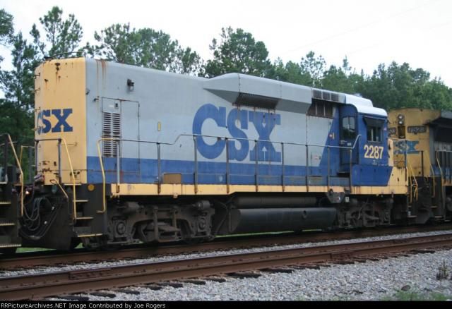

Hey guys, I’m tring to find HO scale doors that match the rear set of doors on this unit and I’m not having any luck. Can anybody point me in the right direction?
Here’s the unit I’m talking about:
-Dave
-Dave
You probably won’t find any commecial parts since CSX 2287 is a road slug made from a retired GP30. The sheet metal is considerably different from when it was actually equipped with an engine.
Cannon & Co makes diesel details. Maybe you can modify something they make.
Cannon website: http://www.cannonandco.net/Home_Page.html
Andre
I’ve checked with Cannon and Co. They have doors, but not doors with the vents on them. I’ve also checked Details Associates and Details West.
Perhaps if somebody knew where I can get the vents? I can always combine them with doors from Cannon and Co.
-Dave
Use the Cannon doors and apply Archer or MicroMark louver decals to them …
Mark.
Cannon doors, and Archer louvers, definitely. See the link below…I’m guessing 6" wide louvers here.
