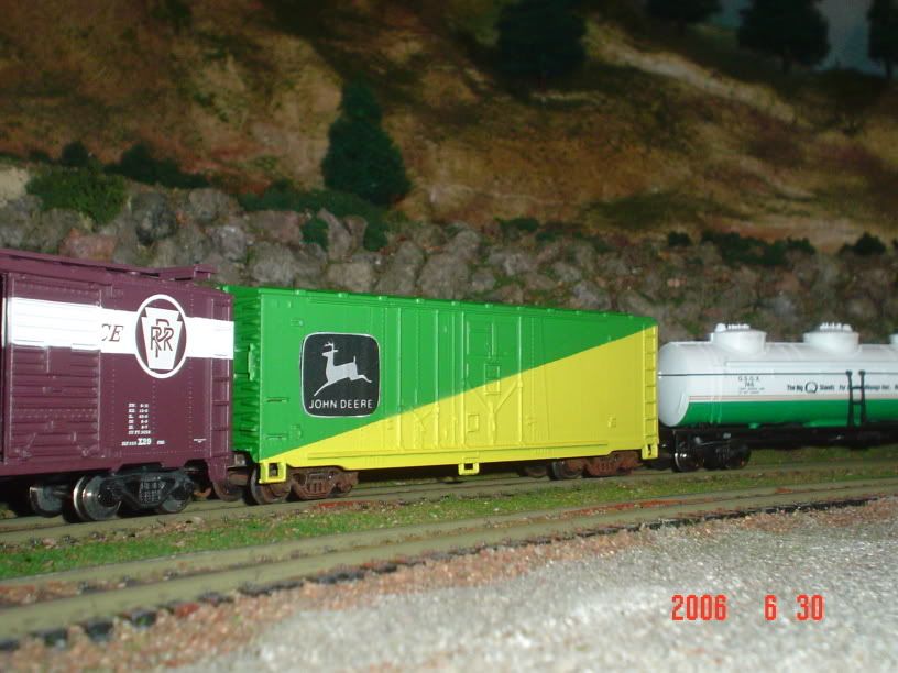

Good morning, and happy Independance Day. I am running an HO scale train with 2 F7’s in the lead, and 20 cars behind. All of them look like new cars and locos.I have tried weathering with not much luck, I always get them to dark. Is there a simple way to make them look used but not abused? any suggestions would be a great help. Here is a pic of a boxcar I painted yesterday, needs more detailing. What do you think?

P.S., Your John Deer car looks great. Simple, but really stands out. Trucks look good too.
Thanks for all the advice, I will try som of them in a couple of days and see which ones work the best for me. Thanks again. Mike
