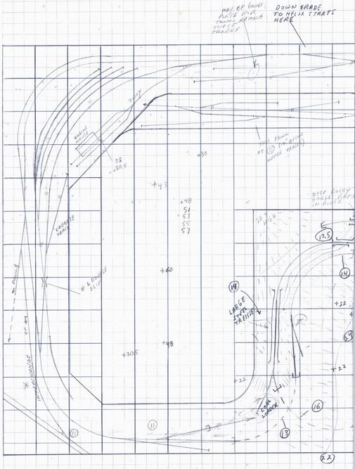

I’m new to posting to this group. I would like to know how to post picture of layout plans I’m working on. I need some help with the yard area. I would like to know what others think; will this work? I’m working in a room that is 12 x 20 and HO.

Okay. The picture is hard to read, but here is a couple things I see. Both “yard” in the upper right have turnouts with no track past them. This means that there are sections of the track that you simply cannot reach. The main yard in the upper right does not seem to have either a yard lead, nor a run-around around. I cannot see how an engine can pull into the yard to be switched out. But again, it is hard to see from the drawing. You have the space for a good yard.
Try this site, called the 10 Commandments of Yard Design:
http://www.housatonicrr.com/yard_des.html
