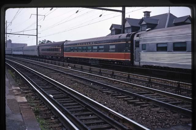

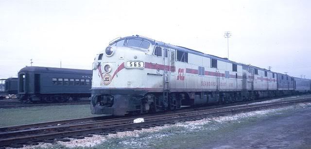

Here’s a typical SCL long distance train. Always a neat variety of equipment.
Some more info.
Unfortunately no HO manufacturer offers an E unit in the SCL scheme. A friend of mine, an SCL guru, explained that the “ancestry” ACL and SAL E units featured a wide variety of external modifications (lights, pilots, body louvers, partial to full skirt removals, etc). This leaves the manufacturers with the nagging question of “which version, style, or unit do we produce that will sell in good numbers and recoup our investment?”
I bought a black (BumbleBee scheme) P2K ACL E8 A&B set on Ebay for a bargain $90 (both powered). A number of prototype E units remained in their ancestry schemes for at least a year after the merger, so I intend to run this pair as is… ACL E8s that have not been repainted yet. You can take this route easily.
A number of SAL locomotives were changed into the “Split Scheme” image. They kept their SAL mint green colors (faded to white) but received SCL lettering. A 10 on the cool scale!
