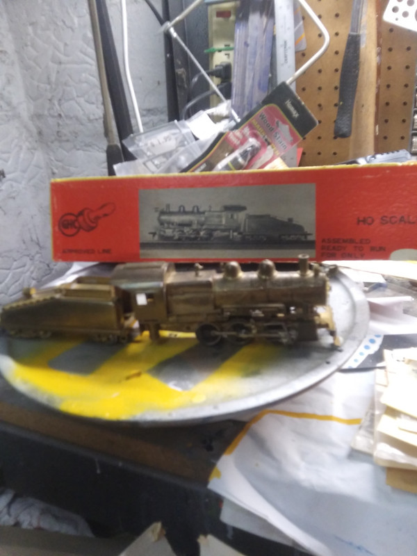

Ok the seller claimed it was never run but it is tarnished and there are several Kem Tron detail parts included.Did not pay much so my expectations are modest.When it arrives I will give a detailed report as well as pics.Will keep you guys posted.

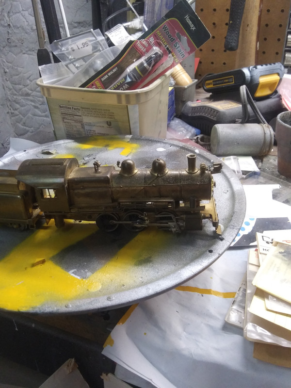

Ok it arrived today!made by GHC out of Japan for the H.O.Train company of. Philadelphia.Seems nicely detailed.Pribably needs cleaned and lubed…
Well, that’s always an exciting moment! The debate is open whether you should lubricate first before doing anything. If it was me, I would test it as is to see if the wheels turn, on a very short distance. I don’t like lubricating before painting - because that’s what I would do… Some will advocate a light oiling before doing anything.

Yes I was very impressed with it!nice fine piping detail and brass castings as well as intricate side rods and other valve gear.Hope it runs as well as it looks.I will remotor if Tom (LHS owner)recommends it.

I put it on the test track last night and the headlight lit but the motor did not run.I will take off the boiler and see whats what.I have previously made a Bowser 4-6-0 so I should be able to to see if the gears are frozen or the motor.I noticed that both the motor worm and main drive gear are both brass.I expect it to be quite noisy!
So the power is getting there… Was the light dim or intense? If the light is dim, it might be not getting enough power through the wheels to get the motor to turn. I would open the boiler and see if the wiring to the motor is correct and try to turn the motor shaft manually (assuming it’s an open-frame motor). You can apply 12v directly to the motor power leads to see if it’s still alive. It should work.
Simon
  1. The headlight is quite bright and the tender was connected properly.
So you need to open the boiler and see if the wire going to the motor is still there and working…

PRR class B6s. It appears to have a lines west coal bunker extension. Not positive but it may be 1960s vintage. Open frame motor and direct drive worm?

Brass main drive gear. Brass motor worm.Should be noisy …the Bowser has a nylon main drive gear and it sounds like a coffee grinder but runs very well.
