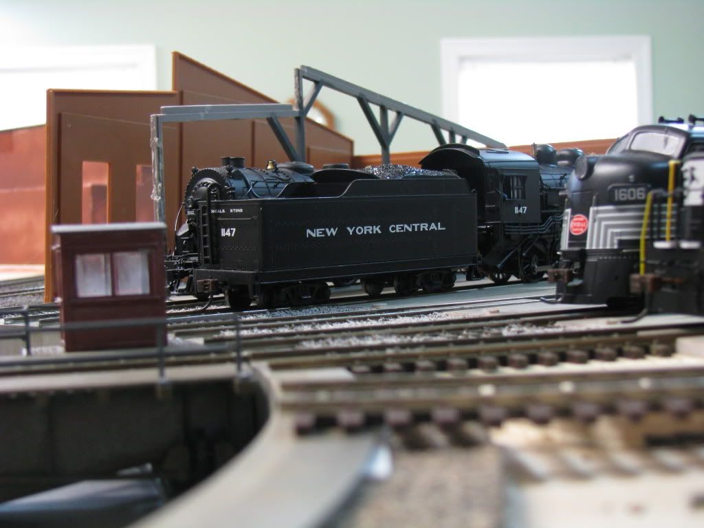

I measured the one on my Walther’s 130’ TT and it is 1.00" long, 11/16" deep and 1" high at the lowest point on the sides. It has a curved roof which is optional since you are building your own. It has a 2-pane window on the long sides and a single window on the short end. the other short end has the door. Hope this helps.
-Bob
Sorry, I had the wrong pic posted, here is the correct one.
I built mine from some scrap styrene and windows and a door from my parts supply dept.
