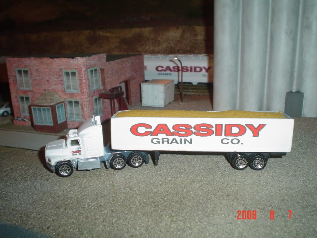

Well here is what I have came up with so far.
I do not like the color of the trailer and going back and paint it white, and the color of the wheat I think needs to be a little darker so I am going to add a little black to my paint. What do you think? Mike

otherwise looks okay so far. What’s wrong with the truck colour? if you paint it white will you keep the lettering?
Here in SW Okla when the wheat is loaded into the truck from the combine and heads for the elevator it is generally less than 10 miles and mostly on gravel roads, and would take to much time to tarp and untarp so they generally do not tarp unless there is a cloud approching. As for the color of the trailer the silver did not lay on as smooth as I would like, and I will simply make new decals. Arn’t decal makers fun? Mike

I think that wheat from a distance would look lighter than what a scoup held in your hands would look like. Again, just this scale distance thing I always try to consider.
The color in this photo looks not too bad to me.
As others have posted, once grain has been trucked even a short distance, it would settle out. And I agree with the others, most times I is covered by a tarp.
Also, i like the sand paper suggestion that some else suggested.

I love the concept and I like the open look. My first take on the pic was a load of shelled corn, the texture is too course. I still am curious about sanding dust, maybe a mixture of yellow pine and white cedar. As I remember wheat in a box car, it stacked a little more than what you have it. I suppose a rough gravel road would settle it some, but it is pretty mounded in the center when it comes out of the combine, is it not??
ART, I agree with you after looking at the pic, it is to course, and the color is still not right. I will try some sawdust and see how it looks. The load of wheat is easy enough to change since it is simply some fine sand glued on a piece of foam then painted. If I am not mistaken, wheat will settle during transport, but will not be real level on top but not rounded like coal. will let you know how the sawdust works out. Here is a pic after I re-painted the trailer yesterday. Happy Monday Mike
I like the white truck and great lettering concept. I noticed you put the grain load in backwards this time and it looked better shape wise. Little things make more difference than they should. I also noticed that the truck now matched the grain car, but the colors on the lettering are reversed. That is a great touch.
ART, Man I am really on top of everything!! I hadn’t noticet the colors of the lettering, but I think it looks better in the last pic. Thanks for pointing that out to me. Maybe that has something to do with the problem with my tree color LOL Mike
