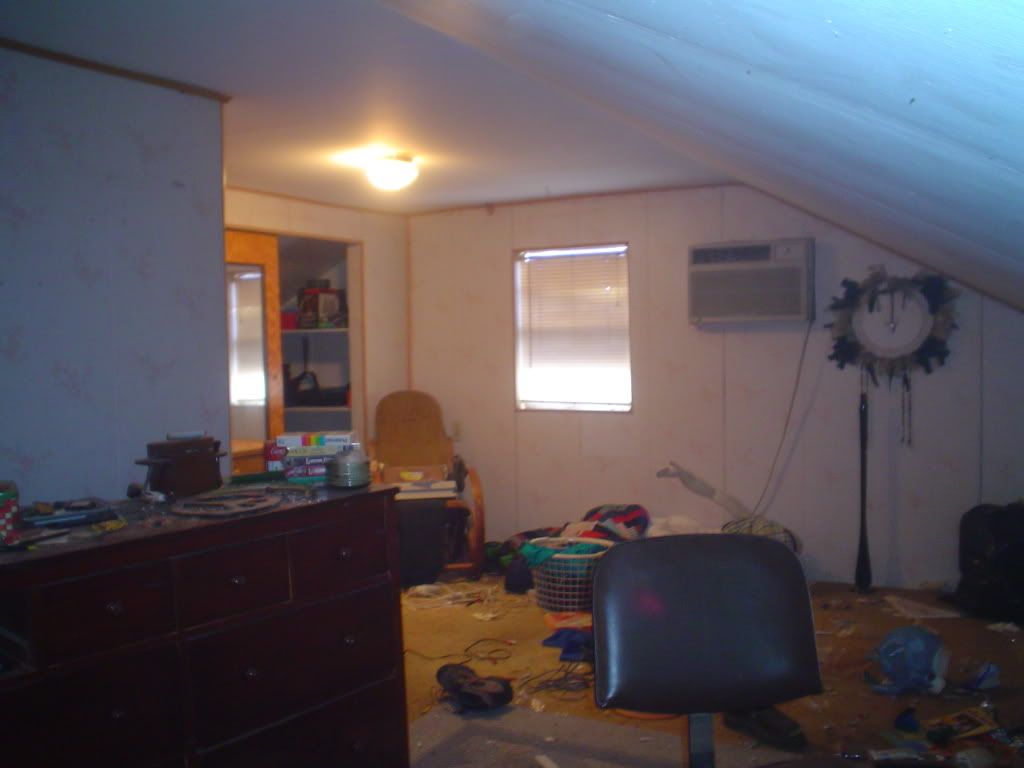

Need your opinion on building new HO rail road.
I have taken a few pics of what I have upstairsand would like your input on a track plan and any other info that may be useful.
The first two pics are looking Soute down the center wall which will probley be removed. Please excuse the mess, I still have a lot of cleaning to do.
The final pic is of the end of the room, The closet and the wall on the left can be remover.
There is adiquit electricity and can be heated and cooled rather easy. Looking foreward your input. Thanks. Mike
