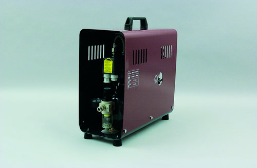

I bought a Sil-Air 15/D a year ago. It costed me around $600. It’s VERY quiet (like a refrigerator) and I love it. I can use it day or night without disturbing anyone.
http://www.silentaircompressor.com
