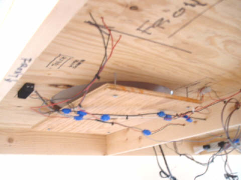

The photo below shows a simple mount that will allow all manner of vertical and angular adjustment to the TT pit/bridge assembly. The adjusting screws are just deck screws with a smooth shoulder at the head which allows the screw to turn freely in the 1/2" plywood mount. The threaded end of the screws move the mount, and pit, with respect to the layout surface.
Once adjusted the pit rim can be blended into the scenery with flexible caulk. This will allow re-adjustment if your layout is subject to “shifting”.
With all that said I don’t pretend to have the perfect implementation. I still get some jerky movement occasionally which I think is due to leaving too much slack (slop?) in the bridge-shaft/pit assembly when I assembled the bridge to the shaft. I didn’t take time to think it through and I need to redo that part someday.[B)]
Jim,
Way cool pic. It gives a better description than anything written!! The ability to make adjustments without tearing the whole thing down is excellent! Would love to see the topside pic too!
