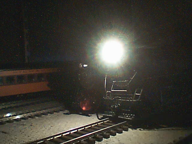

Anyways, heres the real engine with superbright LEDs installed, the microbulbs died.
It has a heavy steam Tsunami but I think I might change to a Titan once I know the whistle. I have a titan in my NKP 4-6-4 and I was surprised how well it synced the chuff to the drivers and NO cams.

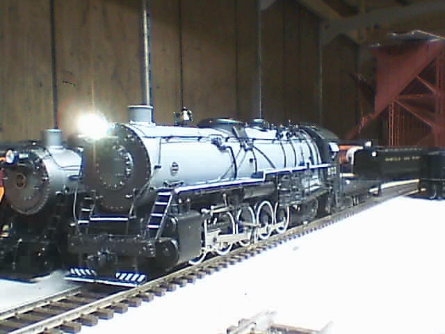

thru various circumstances I got an extra QSI medium Steam titan decoder I decided to place it in the 0-10-2 and pull its soundtraxx into my N&W Z1a. got the decoder in, sounds great, then hit some run tests.
It started having quirky operating, the universal joints were clamming up, I then superglued part of it to stop folding up. new test run, it hung. balked try to go, nope.
Found the left front wheel tread tilted off the wheel…and some pokes around the wheels I found the main driver right side was slipping on the axle. I emailed the seller but its my fix to do and do right, its fine, its fixable. I believe the engine was re-geared which explains the odd universal joint thing. and I think its had lots of fun runs, so wear and tear…yeah, gonna happen sometime. Big heavy engine and lots of power. No wonder. Okaaay, well fix it time for the better, put it on the backshop burner while I work over other equipment and research parts etc.
