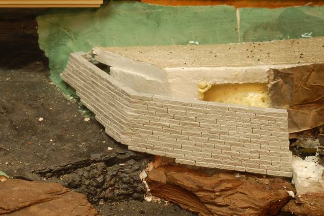

This is a new building block material that I recently received from Dave Batemen (stripes2) of Model Rail Structures.

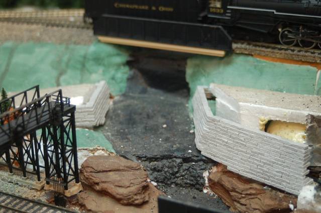

I’ve started to experiment with them and there’s lots of potenetial! I plan on making more abutments and building foundations using this stuff. I use Zap a gap to piece them together.
Once the Abutments are glued in place I’ll be reworking the river bed, banks and surrounding area.
This material is also porous, which means weathering will be very easy to do. Like I said this stuff has a lot of potential and is very easy to mork with.
Fergie

As for spackling compound, well all I used was Zap a Gap (CA glue) and I’m happy with the results. I suspect when I start weathering the gaps will fill up easy enough.
These blocks come in individual blocks, which can be cut smaller by scoring both sides and then snapping the block with your fingers.
The two abutments took about two to three hours to glue together.
