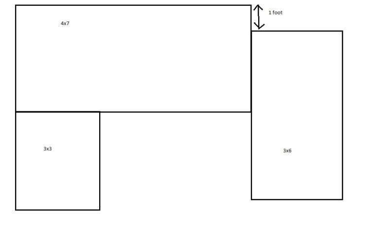

I have had model railroads when a little younger, but never more than just loops. Those get boring after a few days, lol. I have decided to get back into it, in HO scale again. I will preface by saying this, I don’t care if the layout resembles a real railroad, I love the locomotives, so I just want to run them on a fun layout.
I have a somewhat odd area to work with, here is a paint sketch.
I would like to have a minimum of 22" curves as my main love is locomotives, and plan on having some bigger ones. (gas turbine) I would like a long main line a yard, and some switching to industry. Also, I would love a 2% grade somewhere along the main line. I have tried to create some in anyrail, but I am out of segments and can’t finish them. I’ve also tried on paper, but I am just not creative enough to make something that really looks fun.
Thanks for any advice.
Andrew

Interesting problem.
The real gurus will have better ideas, but to get loops and 22 inch curves you will need to get more width than 3 feet on the two small tables. The other issue is what do you want the railrod to do. If you want a lot of opperations you could put great yards on the two ends. If you want a lo of scenery, that will take a different plan. I would cheat and put a bubble on the two end tables and get the 22 inch curves to bubble out.
Crandell - Thank you, I will try to define fun, as it pertains to me. I was hoping to have a nice yard on one of the wings, as large as will fit. One the main section I would like to have a nice size main line that branches off in two places (if it will fit) and one goes to a town and the other to a industrial area. I am not sure what I really want to do with the other wing, maybe move the industrial spur to it?
Yes, I am familiar with the #6 number, and feel that would be best for me, as I hope to have some six axle diesels, and such.
I am also going to call my hobby shops and see if they have the book you mentioned.
Art - True, I can extend one of the wings without any trouble, I just want enough room to sit/stand in the “U”.
Thank you for the input so far guys.
Andrew

I would:
  1. Extend the right hand small table to 49 inches on the end to hold a 24 inch curve.
  2. I would run a double track loop around the main table and the right hand small table to allow continous two way running.
  3. I would put a huge mountain and canyon on the left side of the main table and have a place for a huge trestle and a bridge.
  4. I would put a yard and town in the left small table.
5.I would put a small wooded hill to hide the corner on the left of the large table and fill it with all the trees I make.
  1. I would scatter the buildings and scenes of my choice around the rest. For me that would include at least a logging camp.
Then, that is about what I did on mine. My pics are availble in my signiture. Have fun. I sure did.

i do not understand some responses from others. A gas-turbine is pretty long and a 30" min radius in HO seems needed (3 times the length of that engine). Hence your table will need to be 6 feet wide, you have 3 feet. You are up to a mission impossible in HO, in N-scale you might have a chance.
