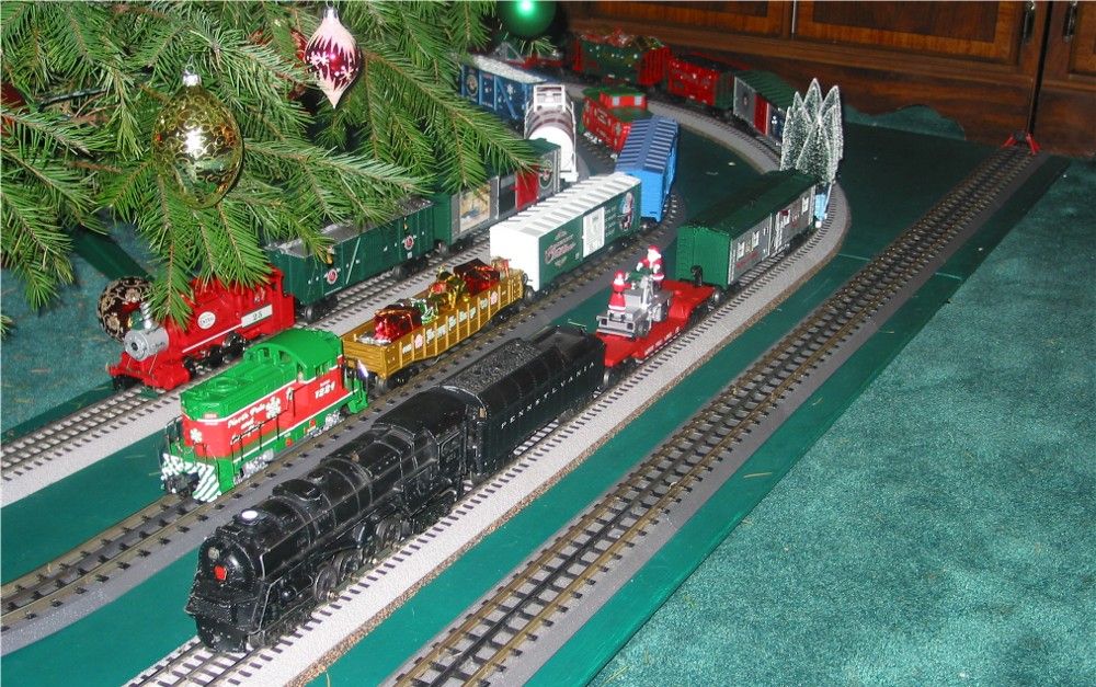

And then our first child Tyler came along, and I had to become serious about it for Christmas. So before his first Christmas, I made this:
I actually had to pull that picture off of the RMT website, as those early pictures (Tyler was born in 2003) are on an old computer and not accessible.
So every year that layout goes up around our tree, and both of my guys have known it since they were born. Here’s they are for Christmas, 2007:
There have been a few improvements over the years: the RealTrax has been replaced with FasTrack, the wiring has been redone, I put risers on it so that it sits about 2 inches higher, which faciliates setting it up, etc. But it comes out every year - here’s my oldest, Tyler, helping to set it up last year (2014) for Christmas:
