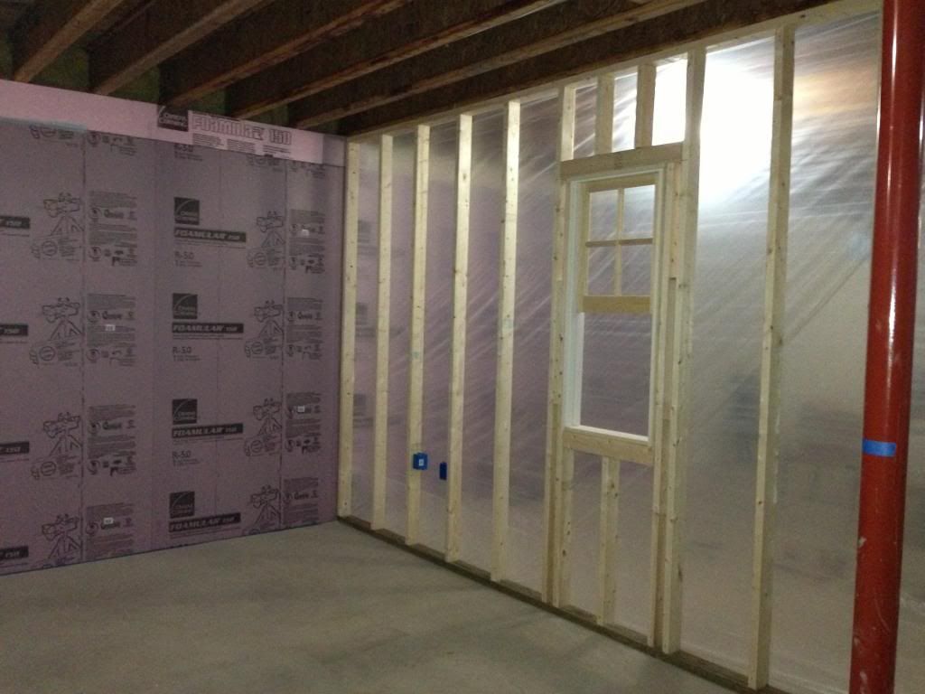

Really great space to work with. Decent ceiling height and clear of pipes, ductwork etc. Whats up w/ that window placed in a basement partition? Just a fixed upper sash. Is it for light or ventilation of some sort? Planning on a dropped ceiling?

I think the window is the enter - exit and escape hatch with the track plan he has LOL. Jim.
Just planning a rec/media kinda room on the other side of the of the train room. Wanted to make that wall with the window look like a passenger depot. Something with a train theme instaed of a plain wall. Lap board siding, etc… From all the replies I see to take my time on the track plan makes sense. It’s helping me rethink a few things… Good positive things. Thanks!! Andy
