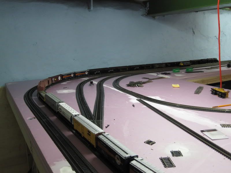

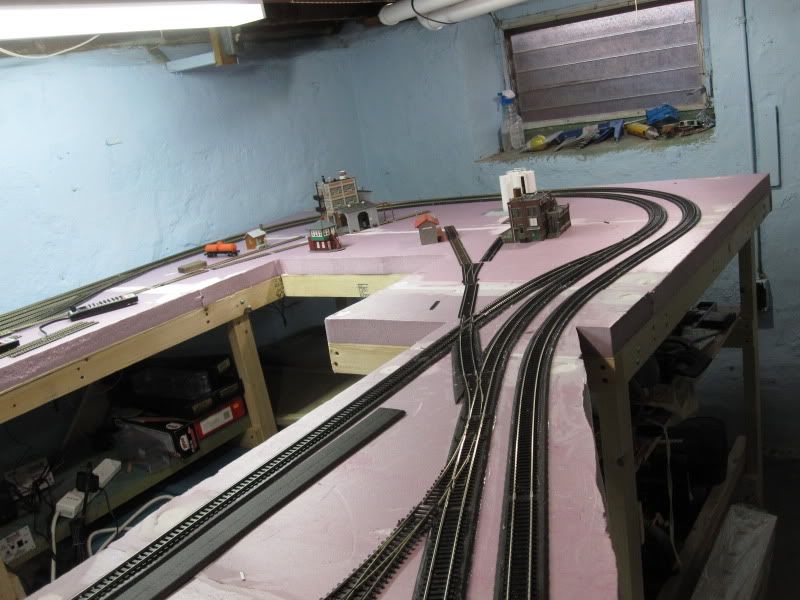

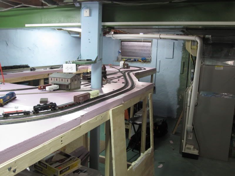

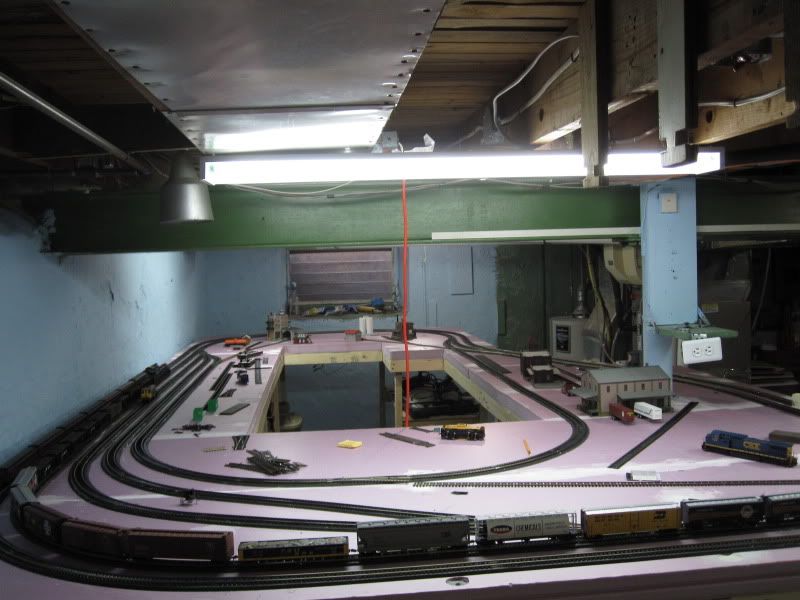

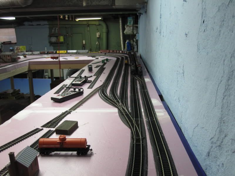

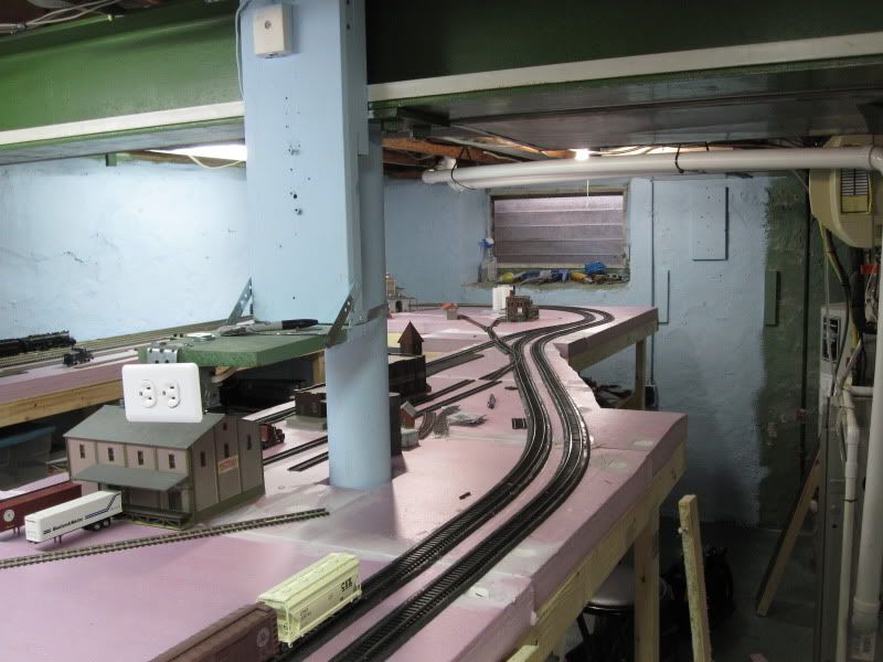

After a few weeks of building the new layout I decided to just run trains this weekend.
Here’s some pics of the layout to date. It’s 15 feet long. 8 feet wide on one end which tapers to 6 feet on the other end to allow service access to the heating/cooling and hot water.

In the photo of the yard (third one down), is the first switch in the yard a 3-way? It appears to flow nicely. Are the other switches #4’, 6’s or something else?
Thank you,
Richard
Thanks
All of the turnouts are Peco’s. The first noted is a 3 way and was perfect for the application and saved space vs a ladder. The radius is 36 inch on the 3 way.
http://www.hobbymasters.com/pecohoscalecode100streamlinethree-wayturnouttrack.aspx
The crossovers are peco medium radius turnouts (36 inch radius) and all others are peco small radius turnouts which are 24inch radius.
