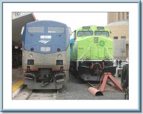

GE in cooperation with UP is in the development stage of a new Hybrid locomotive. It looks like a modified AC4400 loco. I caught this info from the news. I’m trying to set up the Video I have, so all can see it.[8D][8D][8D]
Here’s pic’s of it, courtesy of PCarrell.
Looks alot cleaner(and probably is)than that Amtrak train![(-D]
i have also heard of this. i think what i read was about GE building an electric locomotive that ran on batteries. the batteries alone would produce as much power as an AC4400CW. there was also something about recycling braking power to produce an extra 2000hp. i think it was Railpower that started the battery thing with the introduction of their “Green Goats”. since Railpower dove right into electric locos, i think there will be more electric power on the rails considering GE following. i am unsure about EMD though…
BTW that hybrid locomotive looks radioactive from the front[:D]!

I have been watching it run on our test track now for quite a while. This unit is just a Demo and test bed. The unit is set up to give a boost when needed from the batteries. Dynamic braking recharges the batteries as needed. It can add about 2000 extra HP from what I’m told. The batteries are under the walkways on both sides. They intend to try relocating even more equipment within the car body to have more batteries. The batteries were developed just for this project by GE/undisclosed battery company. It left for the trip to the west coast (see article above) but will return soon for more long term testing. More will be built soon for more extensive testing on the railroads soon.
