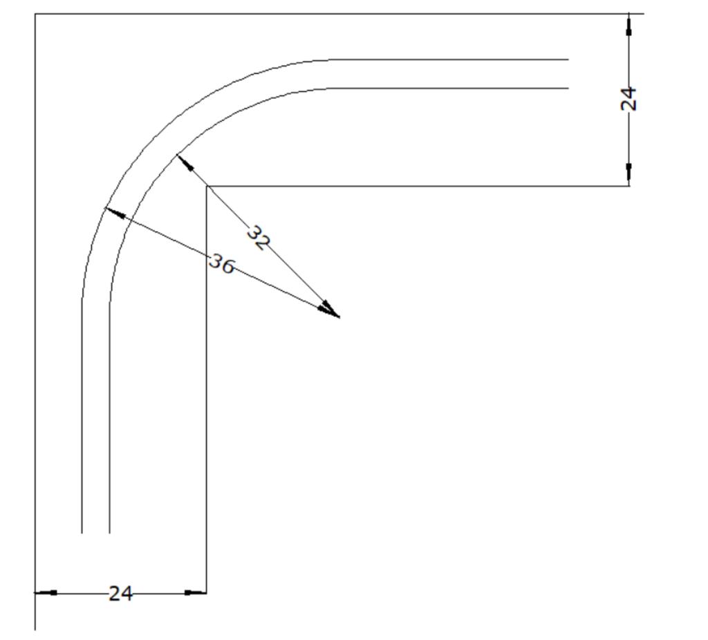

Not being a math major, two 24 inch deep shelves arranged to form an L should provide enough depth for 24 or probably 26 inch curves.
Layout builders have had no problems filling in the squared-off right angle with a little triangle, making the 90 degree turn into two 45 degree turns. This provides enough space for much wider curves.

Just a quickie from my CAD.

Mel’s right - you can easily accommodate a 36" radius curve on a 2’ wide corner-shelf.

I’m wondering why you would want to tighten the radii when your 24" shelves will allow you to do larger curves. Here is an example:
The center of the curve is 32" radius, and there are easements on both ends. If you eliminate the easements the curve will take up a bit less space but trains won’t look as nice going through it. There is lots of space either side of the track shown to run a double line, and the curve can be moved all over the place without having to reduce the radius. It doesn’t have to be in the middle of the shelf.
Also, the gusset is relatively small. It only extends 12" down the fascia from where the shelves would meet at 90 degrees.
