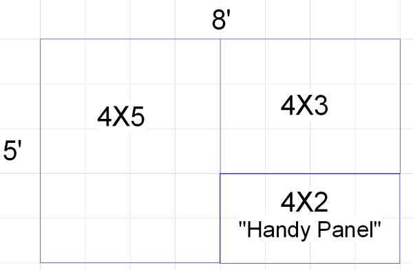

If you can fit a 4X8 on wheels, you can fit at least a 5X8 on wheels. In fact, 5X8, 5X9, 5X10, etc. all make better layouts than the HO 4X8 because they allow a broader radius – especially if you want two orbiting ovals. And it seems like they’ll fit just as well into your space.
The broader radius is especially helpful if you want to run models of more-modern trains, as you say you do. These models tend to be larger and run poorly on the 18-19" radius that’s necessary for the inner oval of a double track HO 4X8.
A 5X8 is not hard to build and would be an improvement. Just cut the 4X8 sheet into two pieces and add a Handy Panel (or have the lumber yard cut the 4X8 sheet).
People are telling you this because they’ve seen the results of trying to shoehorn too much into a 4X8. If you have woodworking expertise, surely you can go beyond an uncut sheet of plywood on sawhorses. [:)]
