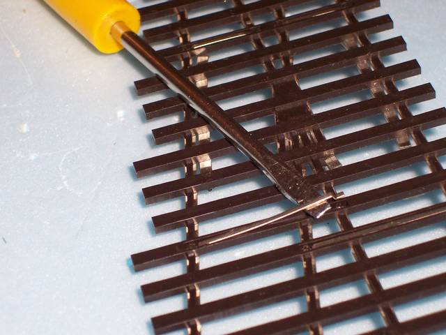

Has anyone experienced problems with the new Walthers DCC-friendly code 83 turnouts suddenly going bad? I’ve had two go bad this week and a new one out of the box that was no good. [banghead] Examining each one, it appears that the small metal strips transferring power between the rails are poorly soldered in place and are turning loose. I’m not real sure how to handle this as the strips are embedded in the underside of the ties and any soldering attempt on my part will melt the entire tie. [%-)] It’s a good thing I hadn’t gotten around to ballasting these yet!
These were all bought at one time so it might just be a bad batch. Having paid so much for them, I’d expect better quality than this. [V] Has anyone else noticed this problem?

Yes on a #6 double crossover and a wye. I have a resistance system so the repair was easy but should not have had to be made. There was no solder on the jumper on the end that was not attached.

I had a similar problem with some turnouts in the past that had a strip like that. The problem was fairly easy to correct. Radio Shack sell a solder that melts from the heat of a match. It comes in thin short strips. dab a little solder flux on the spot to be soldered, put a piece of a strip under it and put the contact strip over it. Touch the whole mess with a soldering iron and it’s done.
I’ve experienced that same problem with many of the Walthers DCC friendly turnouts I’ve purchased. If you’re using DCC for your layout, there really isn’t a problem if you provide a feeder leg to each side of the turnout. The power gets routed back to the frog via the rail joiners. It looks to me that they are using a micro-spot welder to put those little strips on and it’s been hit and miss on their efforts.

Unfortunately, I’m using DC and both of the turnouts are at block cut off points. Maybe I can work around it somewhere. If nothing else I could melt a tie and hide it in the ballast.
Jeff–do you know the name of the low temp solder you wrote about? That sounds like my best option.

I don’t remember the name of it, but if you tell the people at Radio Shack that it’s made to melt with a match, they should know what you’re talking about.

I just installed one of those “DCC Friendly” turnouts myself and noticed how the soldering was a little flimsy. If I have a problem with the turnout, rather than pulling it up and trying to re-solder the metal strip, I will just drill holes next to the turnout through the benchwork and add 22 gauge feeders to the sides of the rail. If done properly, the wires next to the turnout won’t be noticeable.

Thanks for posting about these I have a few in the box just waiting to be put in when the upper layer is being done. Now I know I need to resolder them before I do anything with them. Again thanks. Oh one more questions do you think a small pencil soldering tip should be abe to do this task?

A pencil soldering tip would be excellent. If you have it, use it.
Radio Shack Solder Tape Strips - Part # 64-010 - $ 0.97
http://www.radioshack.com/product/index.jsp?productId=2062716&cp=&origkw=tape+solder&kw=tape+solder&parentPage=search
That’s it, that’s the stuff I was talking about. You don’t have to use the whole strip, just cut off what you need.

The alternative is to solder yourself. http://www.wiringfordcc.com/switches.htm
