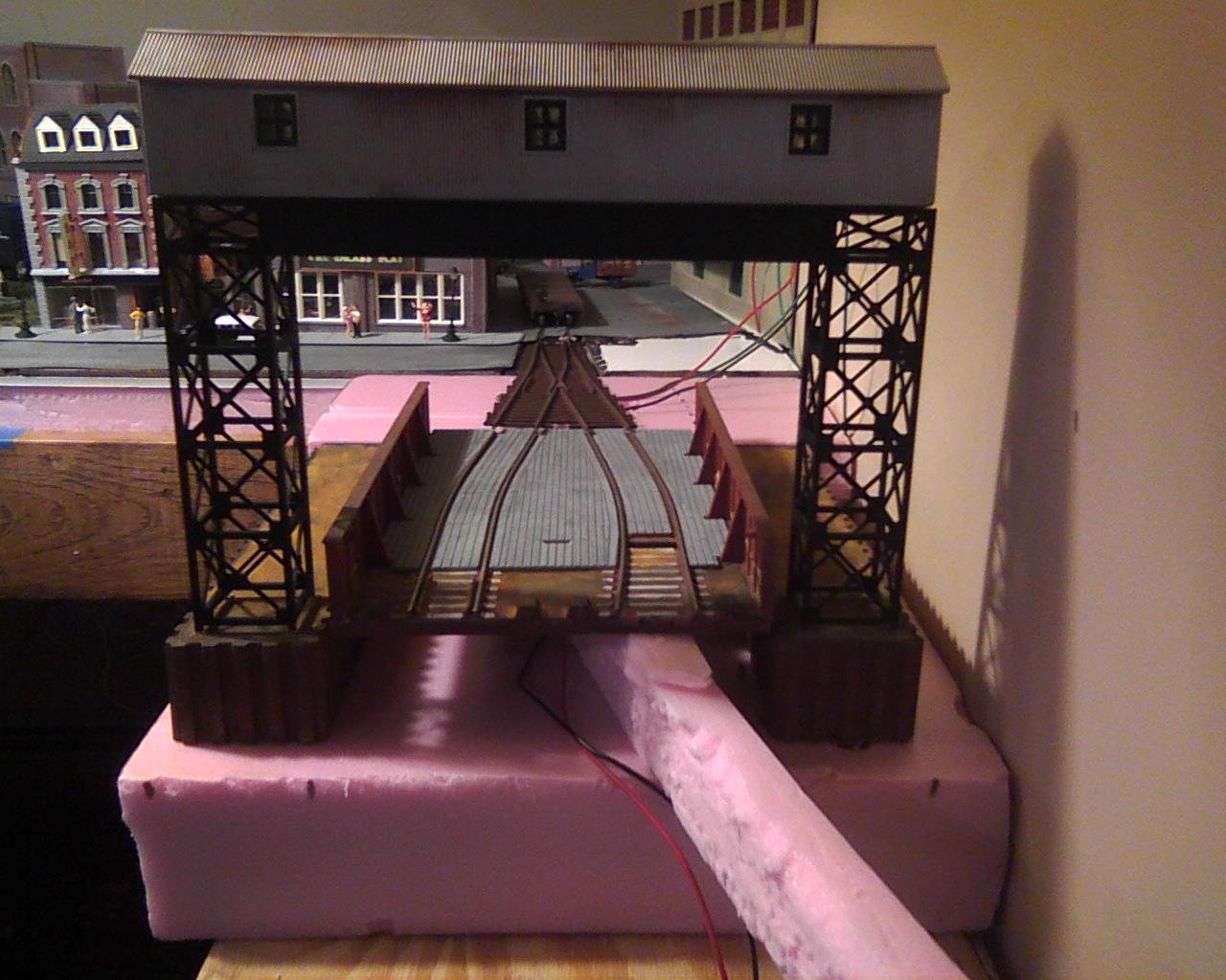

I put together this extension of the benchwork over the weekend:
There is a hinge at the end of the fixed apron section, so this long board can fold down and I can get myself back into the corner when necessary.

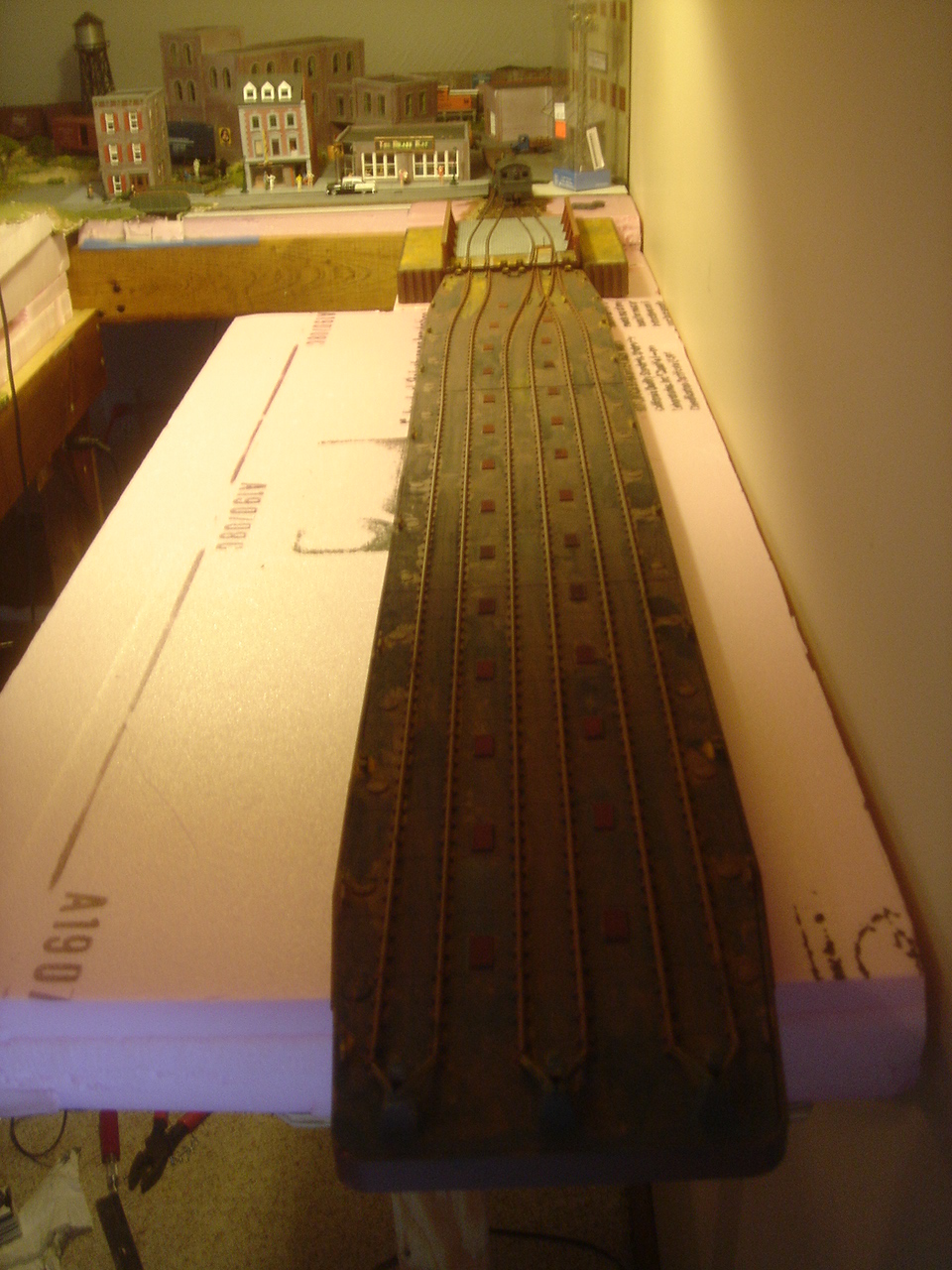

With a piece of foam (oversized, for now) and the carfloat on the board, it looks like this:
The final model will keep the plywood structure. The carfloat and foam section will be glued together, to provide a more solid and stable piece to be moving around.

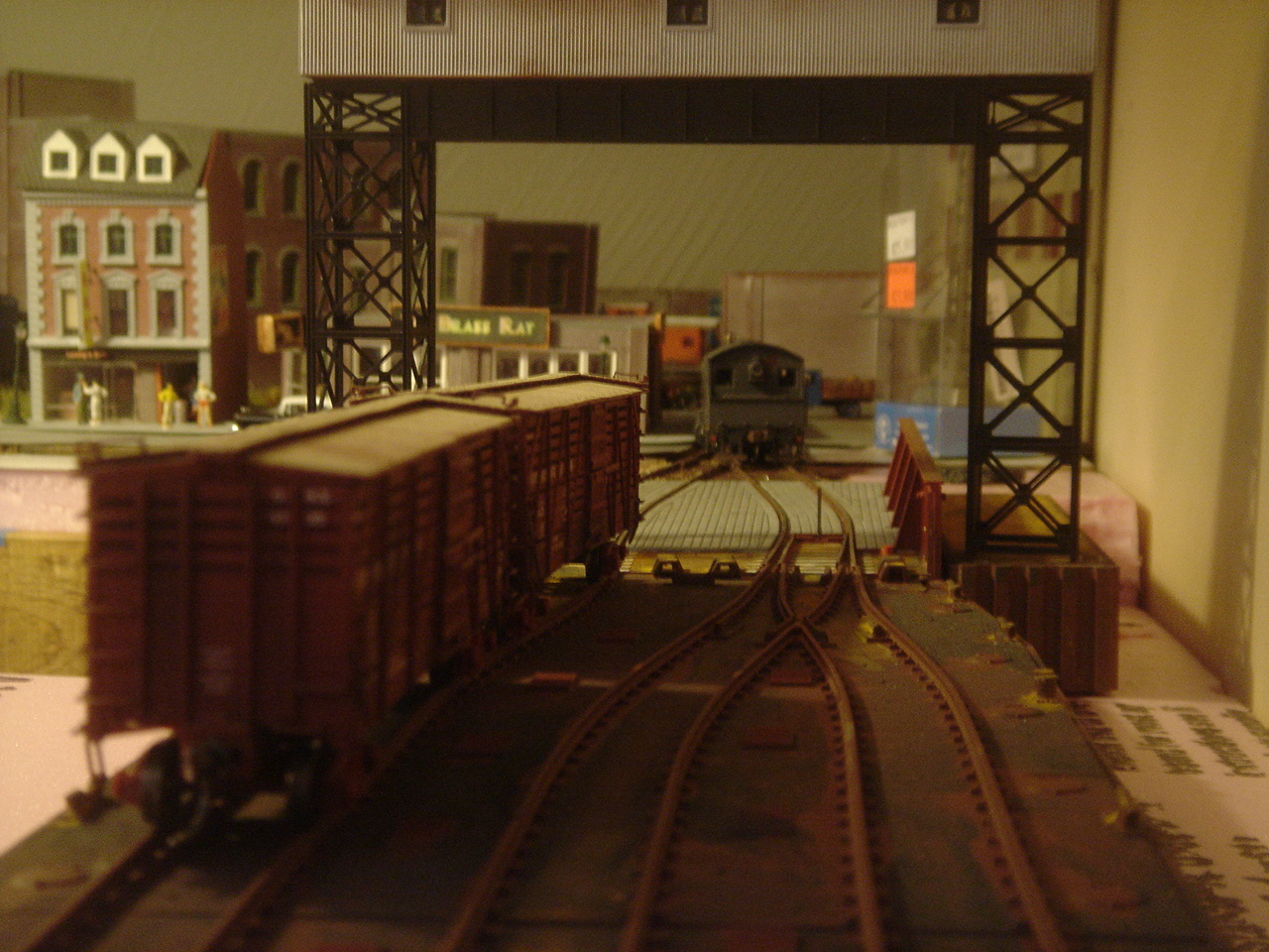

I jumped ahead a bit for this final picture:
The approach track, apron and float base all need some alignment work so everything will be nice and flat, and there is scenery work to be done. The pink foam is, well, pink, and needs some Envirotex to look like water. The superstructure is loosley in place, and behind the apron there are some square inches that need scenic covers, too.

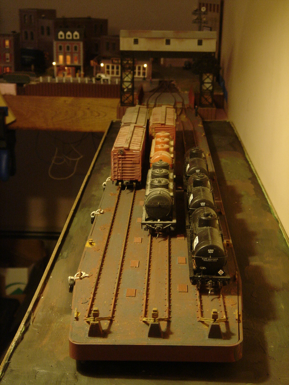

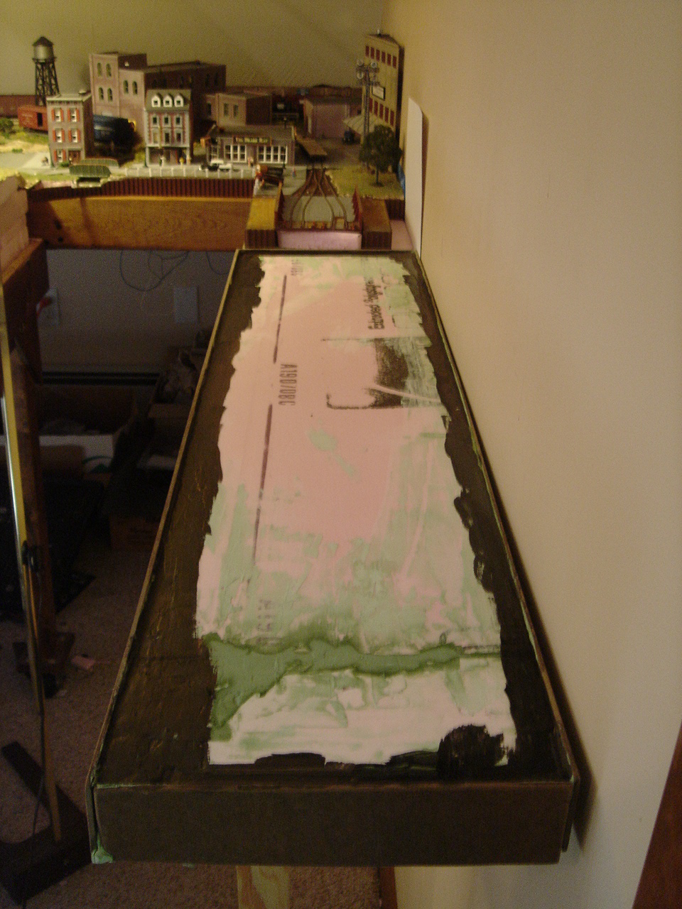

Now that ski season is behind us and graduation is done, I’ve had time to get back to the carfloat project. I built the float base from a piece of 2-inch foam, and put a Masonite fascia around it. I painted the edges, then measured it for the float model itself. The float will be glued to the center of the base, so I didn’t want paint there.
It was pretty quick to paint the base and put the carfloat on, connecting it to the apron to get the position right. Below the base you can see the plywood shelf it sits on. The carfloat is designed as a removable model, so it can be used as a cassette and also so I can get into that tight corner more easily. The plywood shelf is hinged with a fold-away leg.
I put some freight cars on the float to test it out.
The base is still “dry,” but I’ll be getting to the Envirotex this week, I hope.
