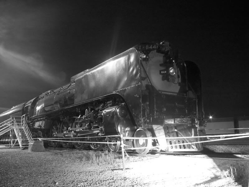

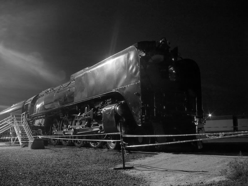

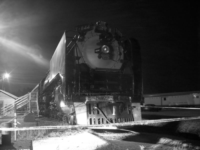

I took these a few weeks ago with Chris’s old Canon D60 up at Cajon. I used a tripod and the time delay setting on the shutter. Both were taken with car headlights. The car sitting on a hill at about mid height of the train. I just played with the shutter time while checking the histogram till I liked the results and then waited for the train. I don’t know if I could have ‘stopped’ the train though as I was trying for this effect.
OOps, I lied. Now that I look at them the first one was illuminated solely with the locomotive headlights.

Nice shots SP 4449. Couple thoughts:
  1. Next time, try to get a little more even illumination if possible. The shots with the headlights on are kind of heavy on foreground illumination. I don’t know what terrain was like where the loco was parked, but if you could have illuminated from the side of the loco at a greater distance, I think it would have looked a bit more natural. If you could have parked on an incline with the lights on the loco a little more, I think that would have helped, too.
  2. There’s a fairly bright light source just outside the frame of the shot. You can see it causing a bit of flare in your shot. If you have lens that accepts filters/etc. try to get a hood to keep out unwanted light. If you don’t, use your hand as best as you can (without getting it in the shot). Recomposing a bit to try to put the extra light source could help, too.
Anyways, nice shots. Thanks for sharing!
