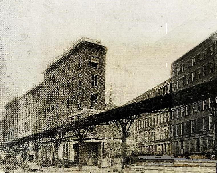

Ninth and Sixth Avenue Manhattan Elevateds
