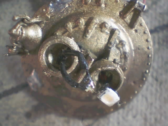

I thought I could light up the numberboards on the side of the headlight using a CAL Scale headlight, but the headlight was larger, and I was also going to replace the mars light, but again the 2 were larger and did not fit the smokebox plate correctly, soooo guess what, I have to use the originals. numberboards also removed because I have a trick to light them up too.

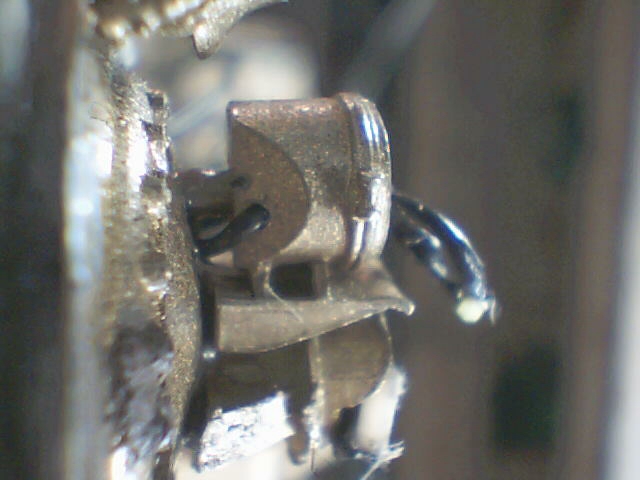

Big silver solder iron removed the headlights, main headlight I clipped the mount off as I had to drill an access hole for the wires, then the headlight is superglued back. Mars light I had to use the mounting hole. Duh…
so to have wire access I drilled two teeny holes slightly to the side of the mars light and the 2 holes in the smokebox, this is how I thread the wires in to the mars light.
thats a super teeny superbright LED in the mars light, I’m getting a knack handling these things now. I lay them down on a reversed electrical tape to hold them down, then solder the wires on.
Leaving the LEDs out for the while while I work on things, then I will finalize them shove them in.

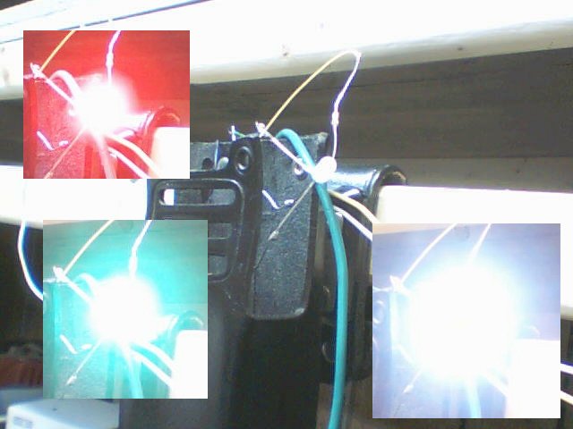

headlight, mars light, number boards, classification lights (3 for 3 color LED to make the green, white red colors)
heres the tri color LED test using the digitrax 4 function decoder. you can turn on the 3 colors to get color combinations tho for marker lights you won’t use them all, but you can get blue and purple and yellow.
I will run fibre optics to the markers to do the effect with the fibre “connected” somehow to the LED, probalbly a micro drilled hole in it glued.
