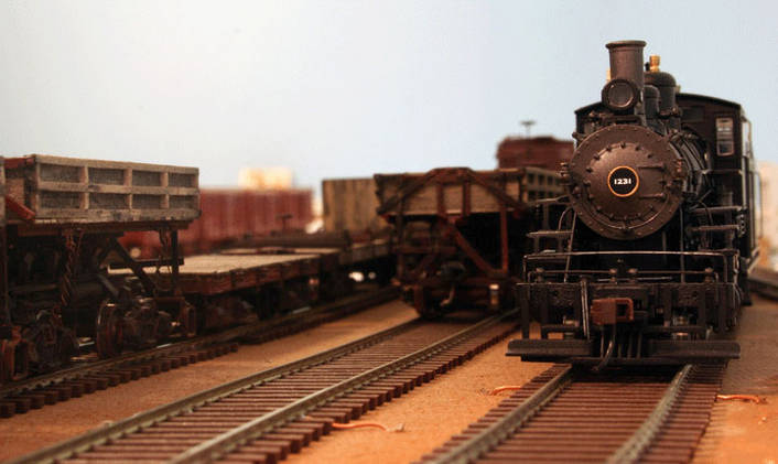

The method you describe is in use on my current layout. No shorts, no problems and one less step to install feeders. To strip insulation from one wire, no big deal, from hundreds of feeder wires is another thing entrirely. This method allows me to solder the feeders to the under side of the rails at the bench and easily hide them in the scenery later. It also allows for smooth placement of the track without having the pre-soldered feeders distort the track geometry,
This shot shows the feeders coming out from between the ties.
